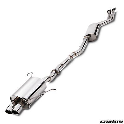

This weekend Hollie wanted to take her Zed to the next level, she’s surrounded by noisy zeds so it was only right we gave it a full stainless exhaust system. While under there we removed the prop and replaced the handbrake mech. The Z4 handbrake has a design flaw where if you don’t pull the button in it wears down the teeth on the mechanism, see here.
Working mechanism we saved from the last Z4 we broke.
nice under shot of everything removed.
then the fun part refitting all the shinny new stainless bits.
These exhausts are a bargain for £340! Such good workmanship.
