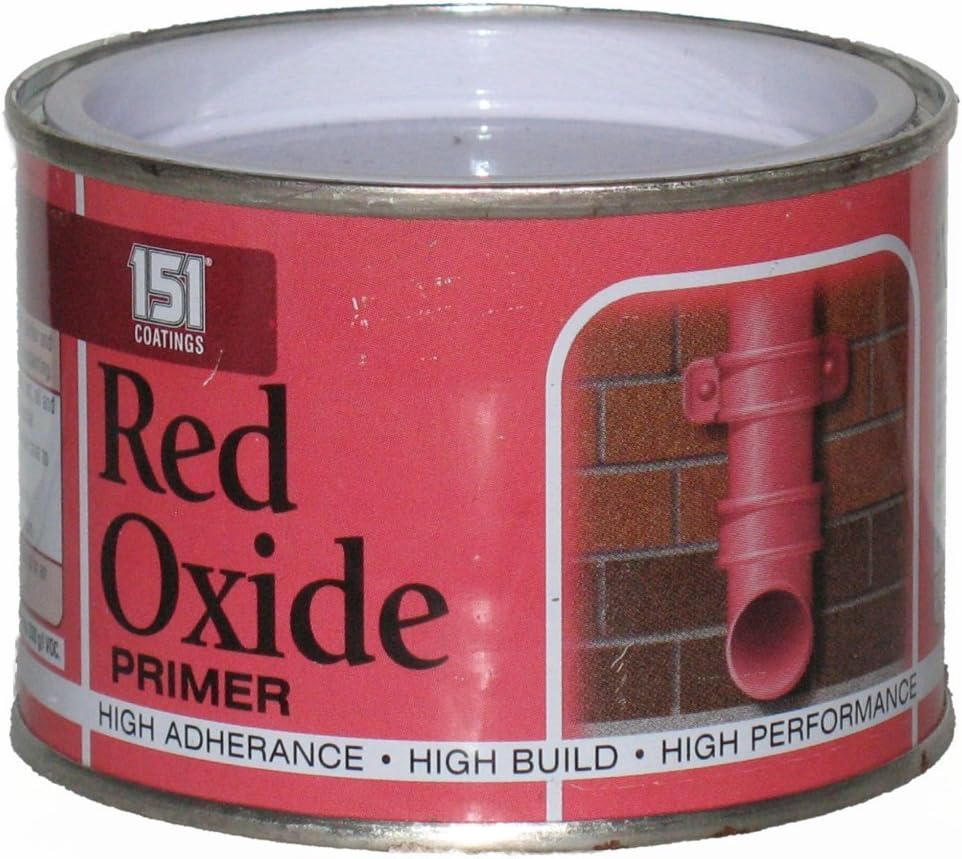

Will be a small clearance but be best to weld the new repair into the shaped hole, cut the replacement to size and hold it in the hole using a magnet, tack the joints on four sides then weld the seams, little at a time to keep the heat down and avoid distortion. Flat back the welds using a flap wheel rather than a grinder to achieve a flush joint, rust proof with chosen product, mate uses red oxide followed by grey primer then a top coat. Cover the whole inner sill with Waxoyle Clear before refitting the outer sill making sure you get plenty inside the pressed holes, I coated my outers with a coat of Black Waxoyle when I did mine, I was lucky the inners were very clean and no rust.
