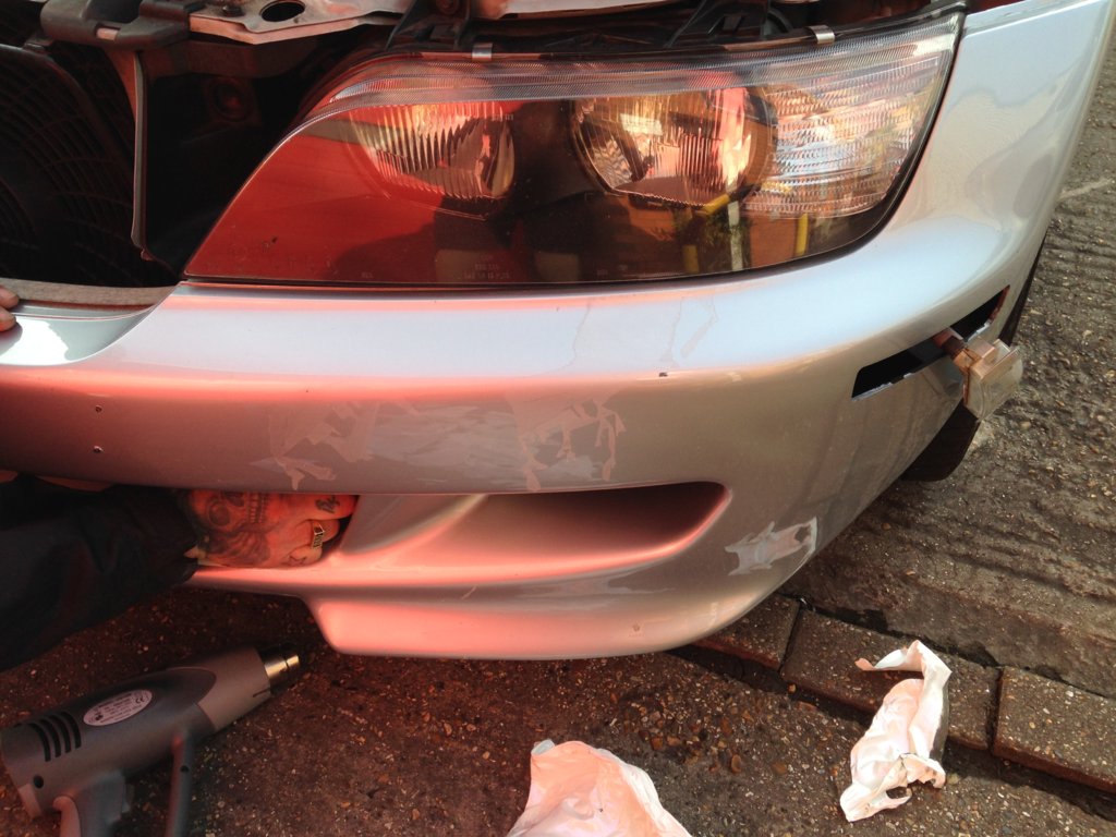

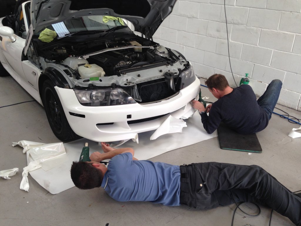

In my case i was removing the old bumper wrap because the weather/stones had got the better of it, but don't be fooled thinking what a waste this was on for over 2 years. The first stage was to heat the existing wrap and gently pull off.
What did happen was the laquor came off the N/S. This was due to a cheap front end respray. Hexis wrap wont hide any imperfections in the body work so any stone chips or un even surfaces will show through.
This had to be sanded down before a new wrap can be applied.

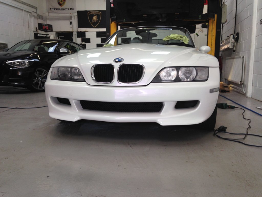

Finally the end result, they also wrapped the mirrors.
