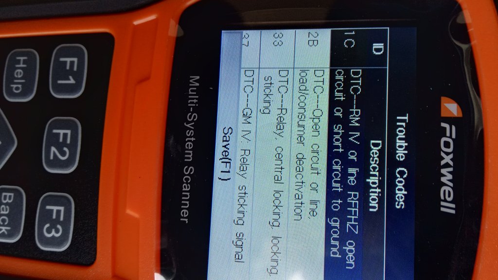

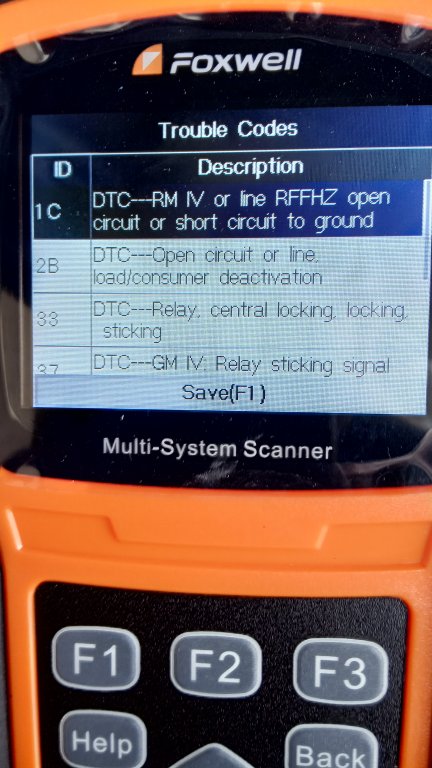

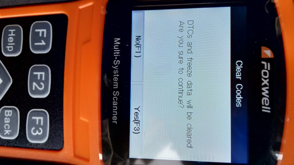

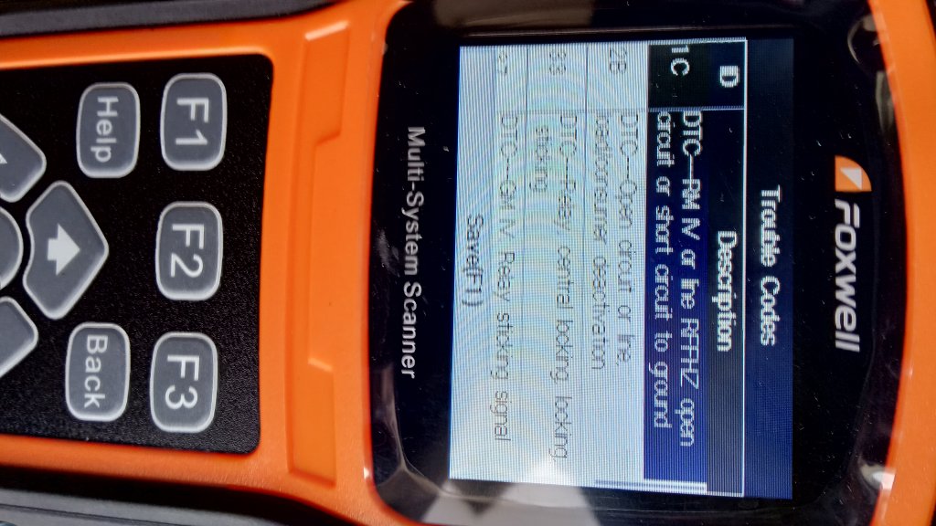

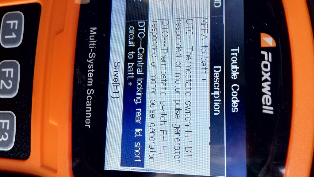

Using my Foxwell to try to read ABS but still no success , but on manual search went into ZKE module and these codes came up , mentions central locking but this works ok and apart from ABS car seems to work ok if I go to clear the codes I get a warning so is it safe to clear these

Car is 11/98 build , there is an ABS thread elsewhere on here which you were a great help with in trying to resolve my issue but doing a smart and manual scan with the Foxwell going into e36 and z3 scans showed up the faults stored but can't find any list of what they mean

For the ZKE codes, delete them and see what comes back.
