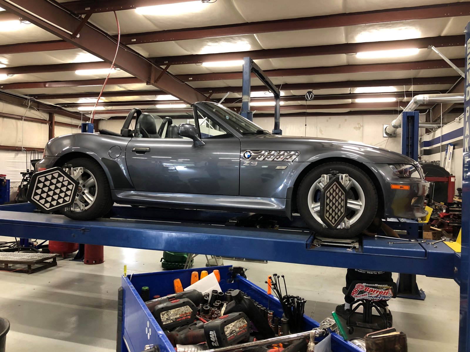

Ok, update on this issue.
The shop said the clutch seems to be ok. They drove it through its paces on a track.They were able to look inside without taking it apart. At this stage, they said that the clutch looks fine. It will be going in this coming weekend to have a stainless clutch line, new slave and master cylinders put it. They are using M parts.
However, there is a lot of play in the steering and front suspension. Also some clutch (trans) mounts needed to be replace. So, they installed new control arms and bushing from an M3. Fixed the mounts and changed the rear diff oil. They had an issue with the alignment process and they said the numbers are off a bit to make it aligned. They also found that the steering was off and they fixed that. Due to the trouble with the alignment, they have suggested to look further in the front suspension. Thinking that a knuckle is out of align or bent. However, they suggested to change the shocks first considering the car is; at 118,000, 18 years old and no history on the shocks which looks original. They also think it might be something with the strut being possibly bent.
I drove it on the highway today, and the feel is a lot tighter. Steering is better and that clump noise from the back when switching gears is less noticeable. The sound is different, not loud, but I no longer feel it in the clutch pedal.
