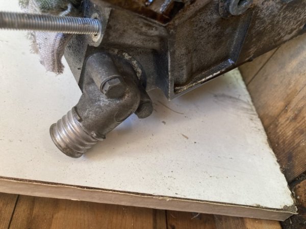

There is an alloy coolant elbow on the back of the head, and that could be leaking. Either the hose or the elbow is corroded.
There is a steel coolant pipe that runs under the inlet manifold. It fits to the block behind the water pump and a few rubber pipes run from from it, to the heater etc.

That seems to be exactly where the coolant has been getting out because there is a little pool of coolant captured between fins on the block below that point. Well done Andyboy as I think we have probably found the problem point. If so relief that it is hopefully limited to that but dismay at trying to work out how I could access the elbow to replace it or install a new hose. Would much appreciate your advice on that please.

I would replace the hose. You’ll need a flexible hose clip driver and very flexible arms. The alloy elbow might be corroded but you’ll only know with the hose off.

Hi Andyboy
Want to go on record with a huge thanks to you for correctly identifying my issue. Warmed up the engine again this afternoon and, sure enough, had coolant spirting from the junction you identified between the elbow and the hose. Hose ordered and will try to fix myself or get the local garage to do. Again many thanks for your prompt and really helpful assistance. Hoping the elbow itself is OK!!
