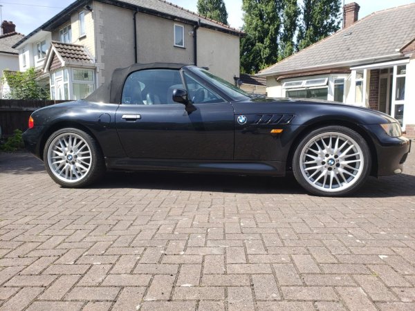

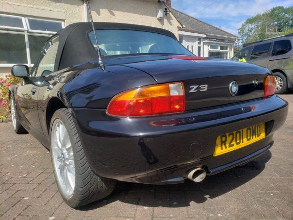

I have been absent from site for some time due to having to sell my last Z. However, I am now the proud owner of a slinky black 1.9 roadster - I attach a couple of photos and will post some more on the photo section of the site.

Your's is an 'R' reg? Mine's not as old as your's. A 'T' (1999). Mine does not have the under dash connector. There's a little plastic blanking cover where the connector could be but there's no connector.
So I'm guessing it's only later cars that have the under dash co.nnector.

Since his car is R reg I am wondering if his scanner has ever worked on his car as its pre OBD2 and not all scanners will connect. I would be trying BMW INPA plugged into it and see if that connects. If it connects with INPA that would allow access to view the state of the key and the EWS. The absence of a spark would point me in that direction and that of the transponder aerial around the key barrel, if they have gone bad the EWS is not going to release the ignition hence no start. INPA should allow the key and ESW functions to be viewed as to their staus and operation. Phils a bit far away from me to give INPA a try so is anyone nearer the Wolverhampton area that could give it a go?
