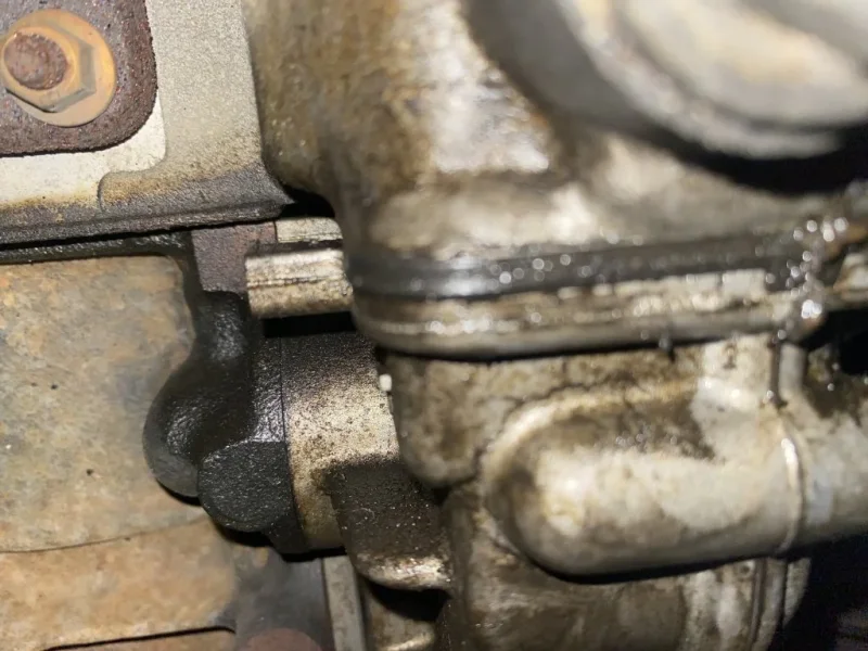

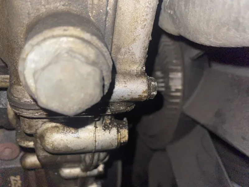

Thanks for the replies! I did think immediately of the injectors, so removed them and had them overhauled. The oil leak is coming from the front o/s of the engine, seems to be a sandwich rubber seal between the top and bottom timing case covers👍
