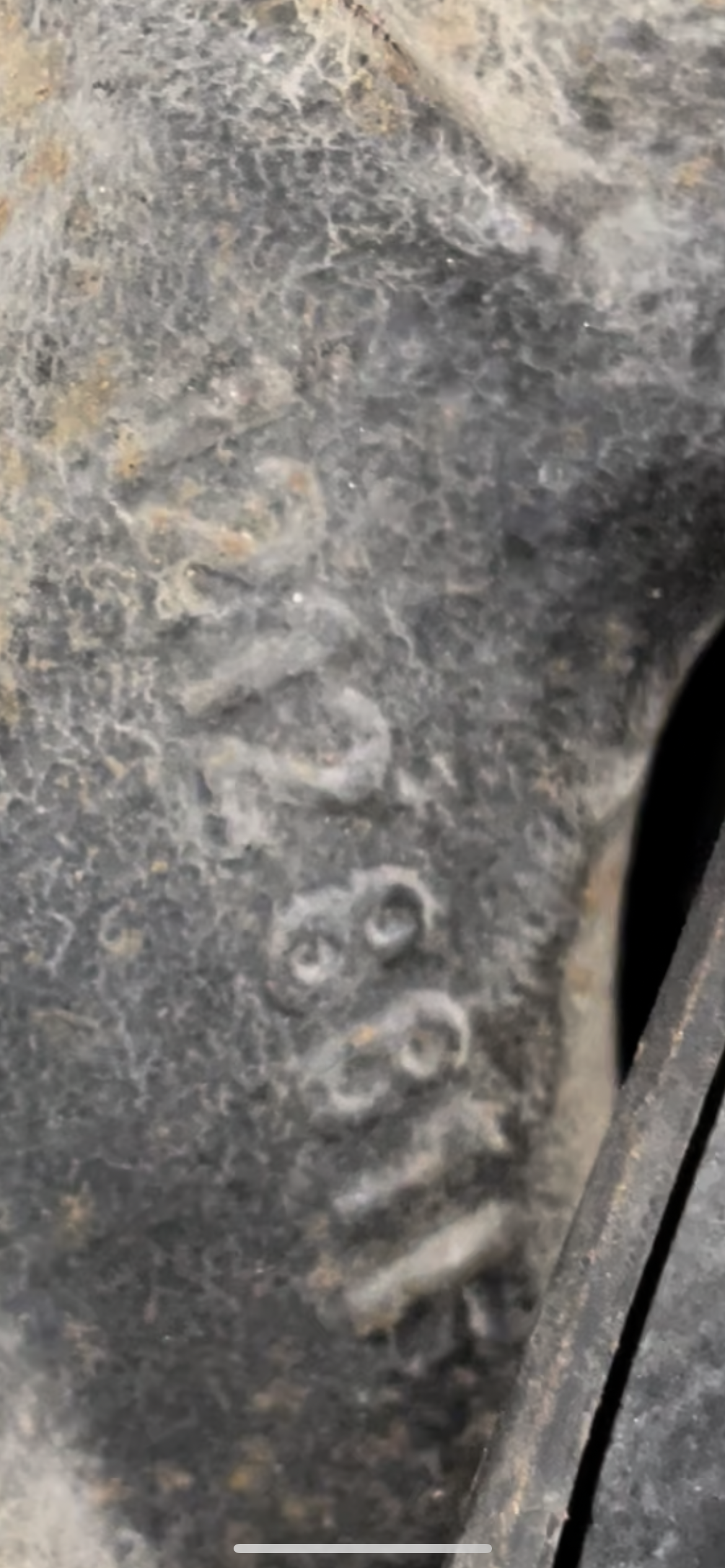

Reads (possibly) 12128811 or 1212881F
No other data on it.
looks like the ratio is 3.46 (turned the wheels and calculated).
acts as an LSD when I rev and let go
acts as an open diff when I rotate the wheels by hand…
Quite puzzled…
image too large to upload, link here

If by 'it acts like an open diff...' you mean that turning one wheel turns the other in the opposite direction then it may well be an open diff. If, however, you mean one wheel turn the other in the same direction then (I seem to recall) it's a 'proper' LSD. The most likely though, is a Torsen diff on which there appears to be no effect of one wheel by the other. Many Z3s have that sort of diff. I would describe it as a 'soft' LSD.

There was a post a couple of days ago. @Lee I think it was. He explained that one of the diff types is an LSD but behaves like a non LSD when the wheels are off the ground - or something like that.
Zephyr
Aug 10, 2022
136
It acts as an open when the car is lifted, but leaves two fine marks on the ground when I rev and let go.
Yes. He explained in detail. But it still bothers me that I can not identify the diff by serial number or other marks.
i will have to open it and check.
i need to change the fluids so want to be sure, because I think that the shop put the wrong oil in it.
i checked my receipts, called them and they said they thought it was an open diff…
So thats why I am overreacting.
