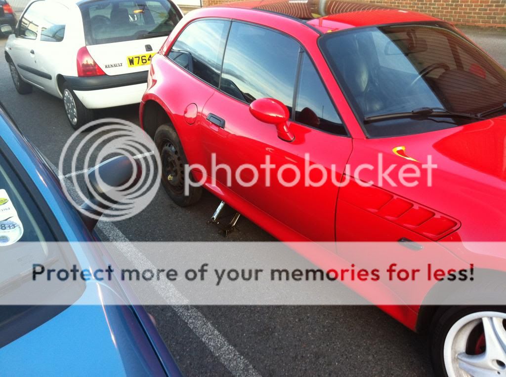

Tyre flat, looks like I've got a drill bit in it!
Spare wheel rusted to pieces and tyre flat.
Not happy to drive on either so stuck at work waiting for a pick up!

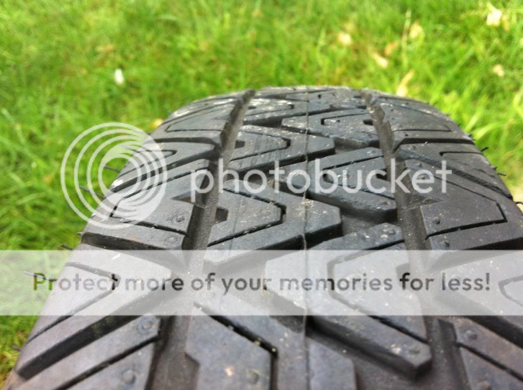

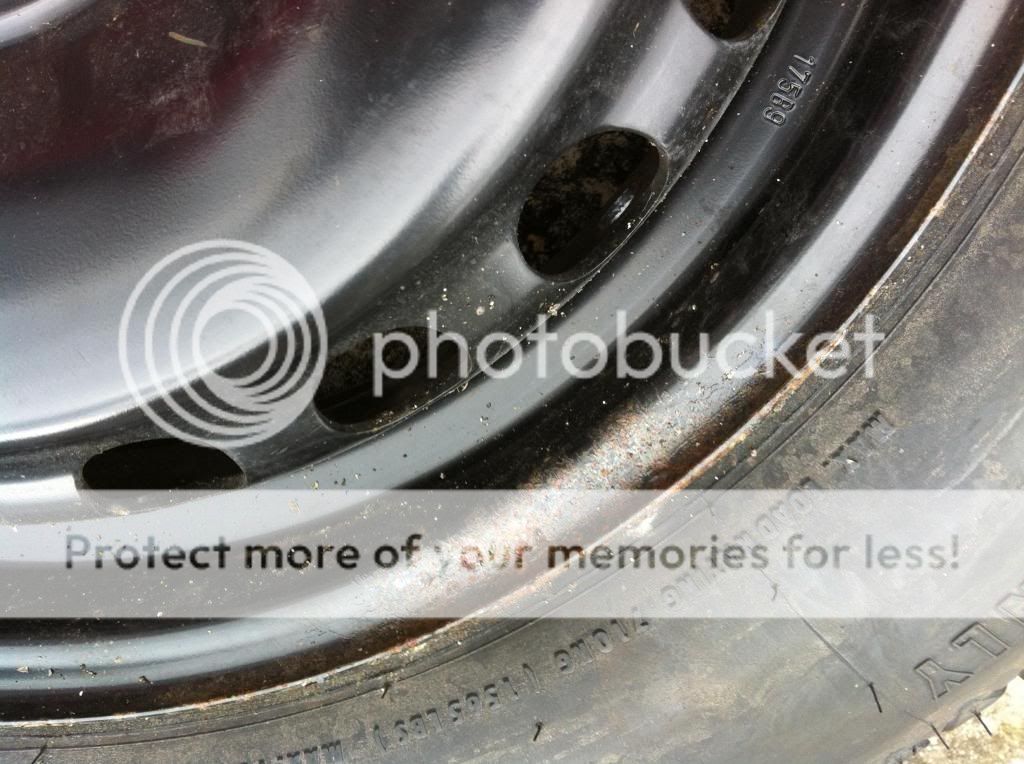

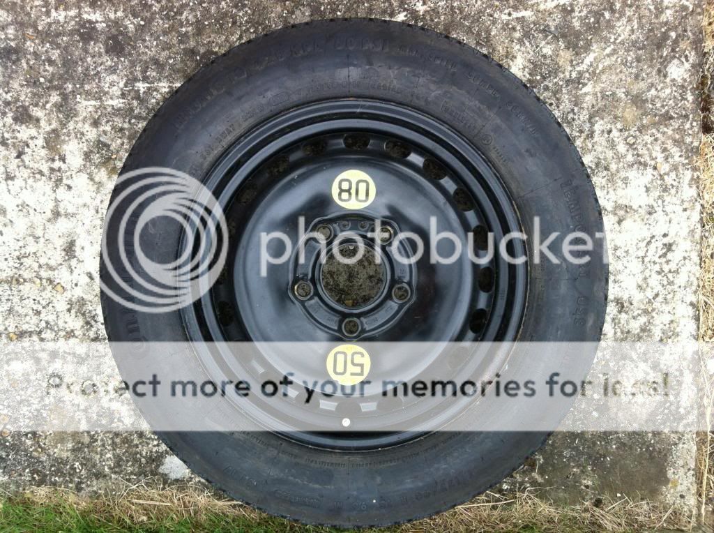

Well I bought an e46 wheel from eBay for £10
Fitted to carrier today so should do me for a few years!

It is a bit of a PITA getting the spare out, but after you have done it a few times it's not the end of the world. My advice is to practice and get used to the procedure on a good sunny day, and not on the hard shoulder when it's chucking it down! A lot of Z3 owners don't check the condition of that spare enough reading the various threads, in fact some are unaware that there is a spare lurking! Lower it from underneath and you might have a nasty surprise, I did, and found a rusted mess, which was an embarrassment to even take down to the tip! Found an 125/90R15 (exactly the same as my Z) on the Bay for £30 as new, I think from an E46 with internal spare wheel well, so not exposed to the elements. I have now placed the wheel in a black plastic bag before putting it back into its tray to protect it, however not convinced whether that's the right thing to do. Will it stop the wheel from drying out or attract moisture?

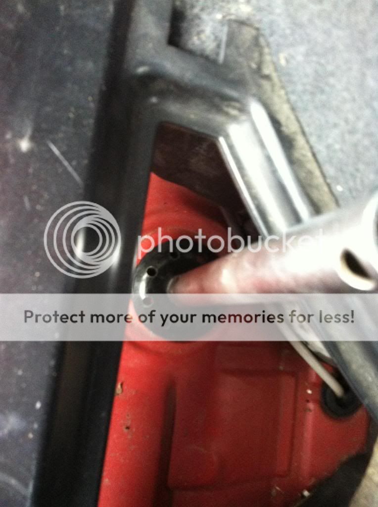

Last weekend, I acquired a straight looking 1997 2.8 roadster. The spare tire tub will only come down a little. I was able to see that I actually have a spare tire, but I cannot get the tub down far enough to really check the condition of the tire. Any suggestions on how to get the tub down without breaking something? (me or the car).

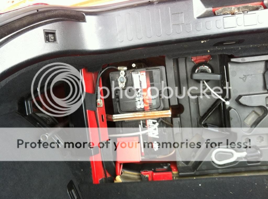

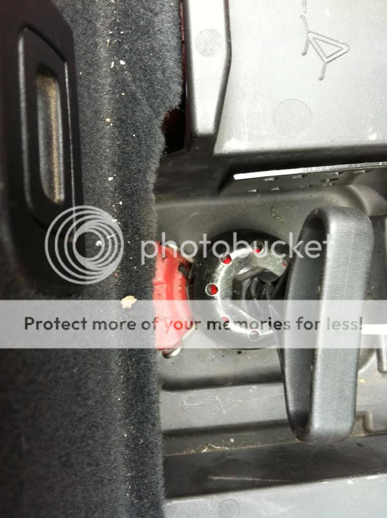

Remove black plastic tray on right hand side, then undo the fixing nut and attached metal flange directly underneath it. This then releases the RH side of the metal carrier, now hold the the black plastic handle (which will be folded over in its fold away position), slide it down and over the LH (which is actually in the middle of the car) and undo that nut and it's attached flange, now hold black handle with one hand and pinch the two metal clips directly underneath, then you will feel the weight of the spare wheel......gently lower to the ground. Slide out spare wheel tray to expose probably on dead wheel and tyre??? Sounds moe complicated than it actually is. Good luck!

The tub is fixed with 2 bolts on the front and the 2 fasteners on the bumper side.
So you should be able to get it out from the other side when you undo the 2 bolt (but it would not be practical on the side of the road when you are having a puncture)
