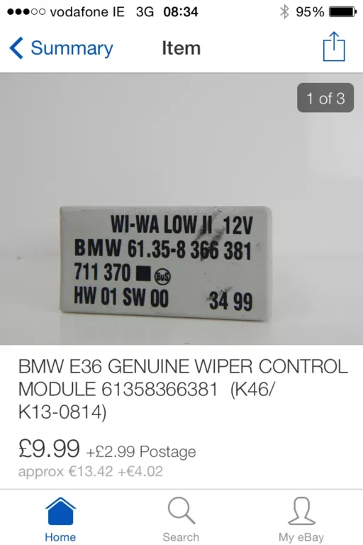

I am a bit reluctant to remove the cowl over the wiper motor if I don't have to, as the plastic clips look about as sturdy as a paper house. So I bought the control module last night in the hopes it could be that. It was only a few quid so worth a try...more than likely wasting my time :rolleyes:
Coffee331
Apr 12, 2015
53
Maynooth
2.0 Roadster (2000)
So....the wiper module arrived in the post today.
Took approximately one and half minutes to fit :)...5 screws drop the glovebox, slide out the old module, slide the connection off of it and reverse procedure to fit the new one.
Sat in the drivers seat, fired it up, switched on the wipers and.............they worked! Boom job done! Didn't see that happening :D
Car with fully functional wipers is now ready for a typical Irish summer. :drinks:
Glad youv'e got it fixed, and spot on diagnosis too. Was the module new or S/H £?
