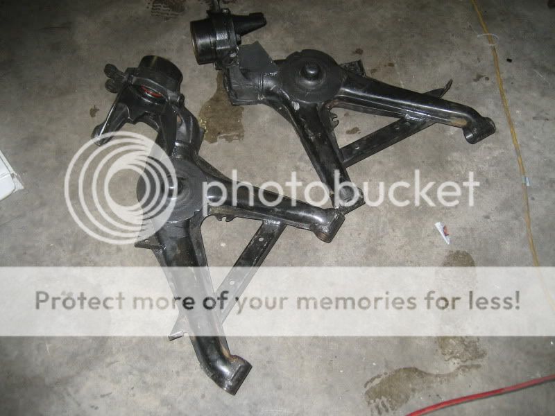

    Our trailing arms look like this
    [​IMG]
    The ones in your link will not fit.
    • Agree Agree x 1

    No this arms in the link will not work, have not got a clue why it says it will fit a Z3.
