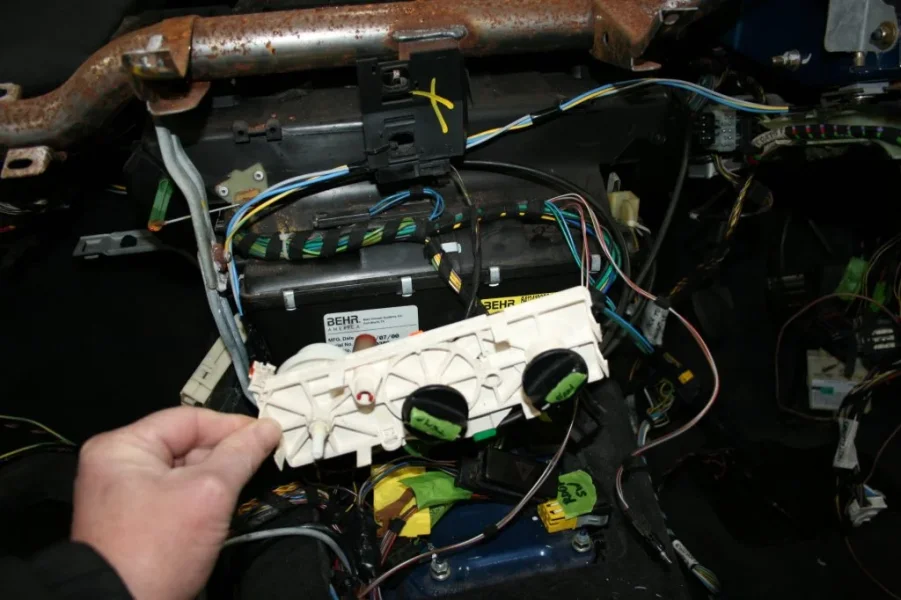

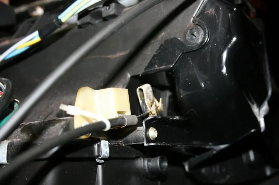

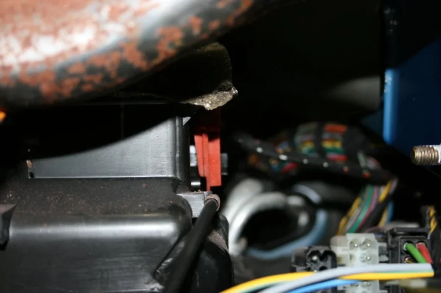

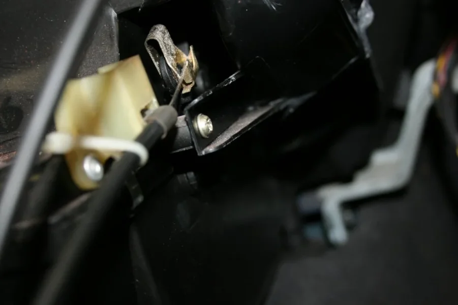

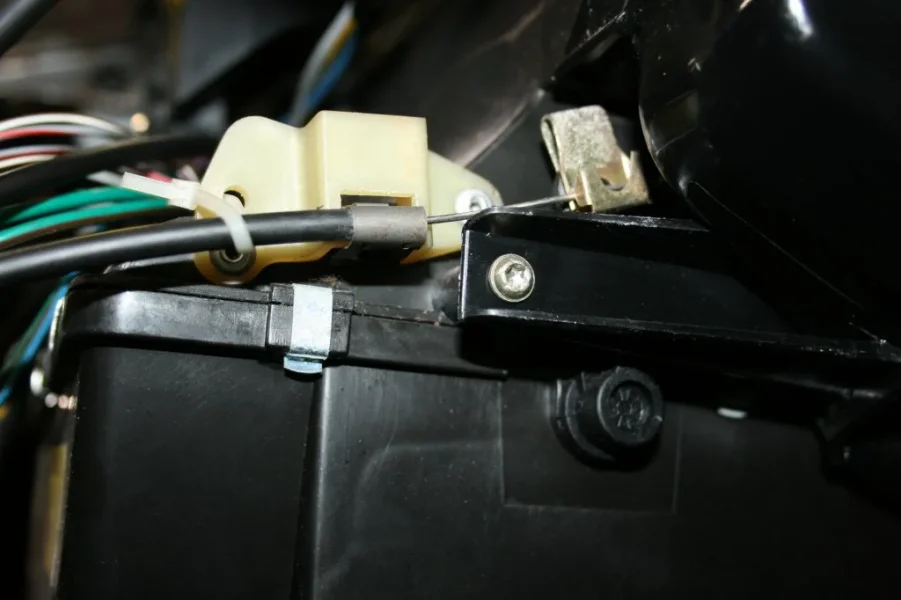

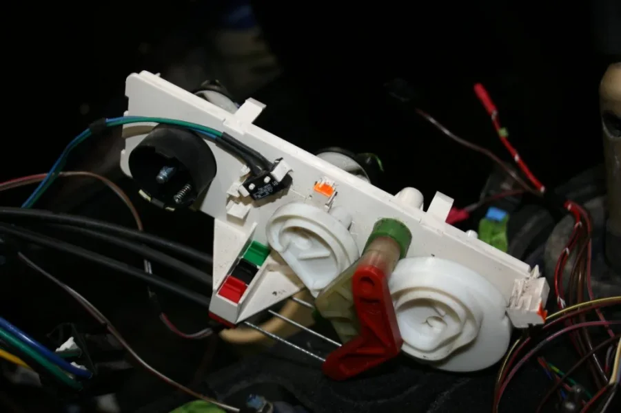

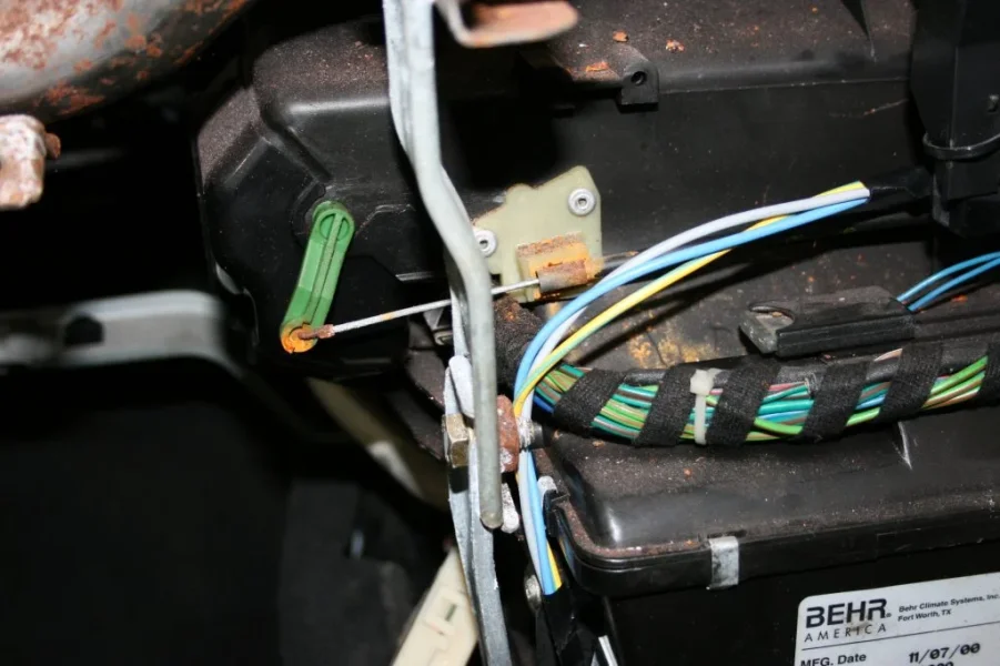

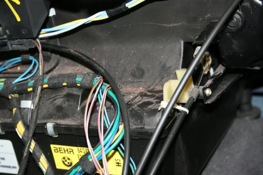

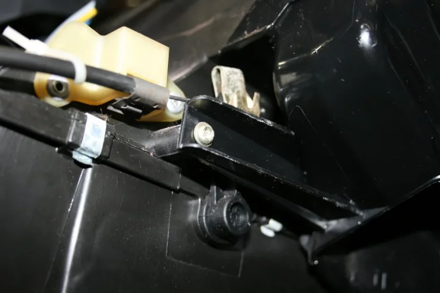

Luckily (or not) I have all my heater controls exposed as I am in the process of changing them all!
I will bet the clamping clip on the heater wire has come off. I pulled mine off when messing about with it and the cable was then sticking.
The pictures show where everything is....green lever for up/down mixing flaps, red lever for windscreen/ front flaps and the plain is the heating flap (out increases heat).
The close ups are of the heater wire and the retaining clip.
Let me know if it doesn't make sense.
