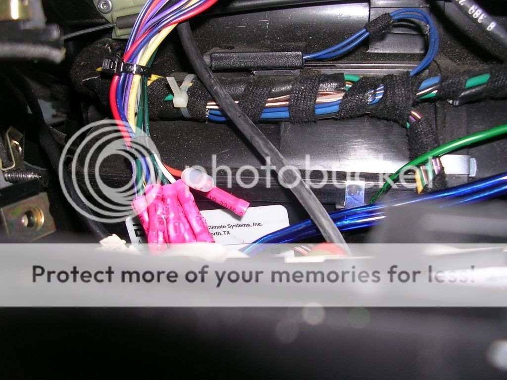

Access is through the center console, which needs to be just about removed for anyone with man-sized hands and non-X-ray eyes. First, the glovebox needed to come out, then the radio. I found a label on the aftermarket radio from a local stereo shop, dated after the car was traded in. As the car had spent the last ten years 700 miles south of here, clearly the radio was replaced as part of the dealer's used car prep. Here's also where we find out, that no matter what anyone says about her, that all sorts of gorillas have had their hands on her. See the butt connectors, and the console mounting screw that's missed its target on the middle left:

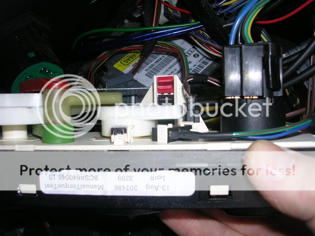

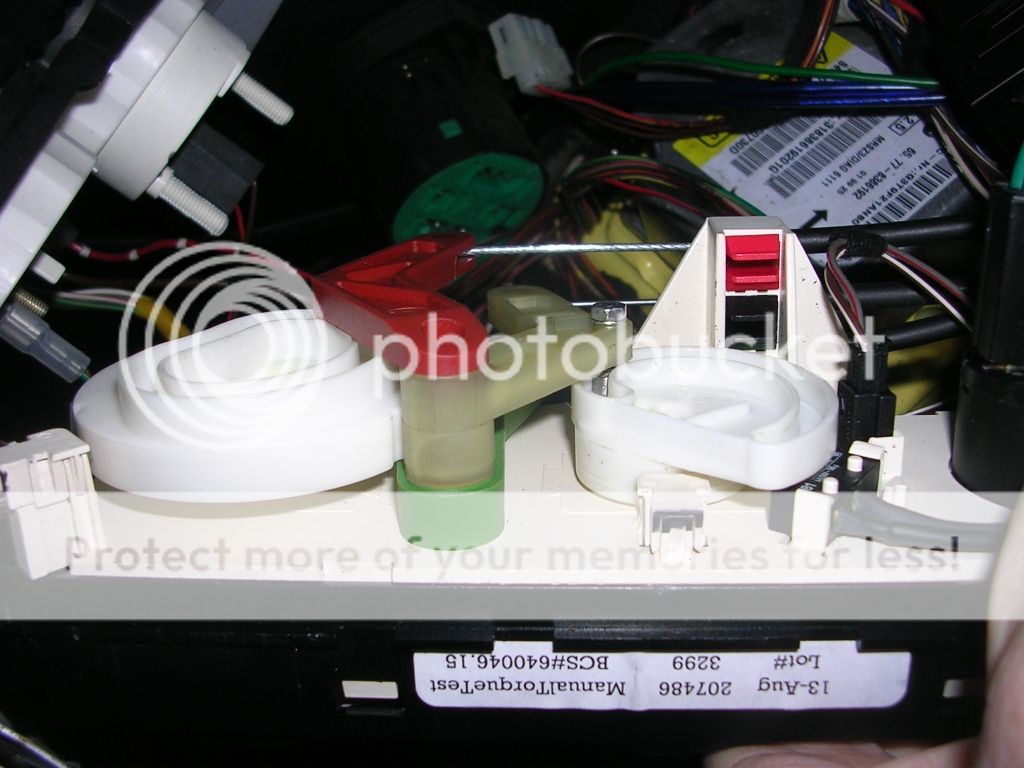

Once everything was out, here's the working side of the controls:

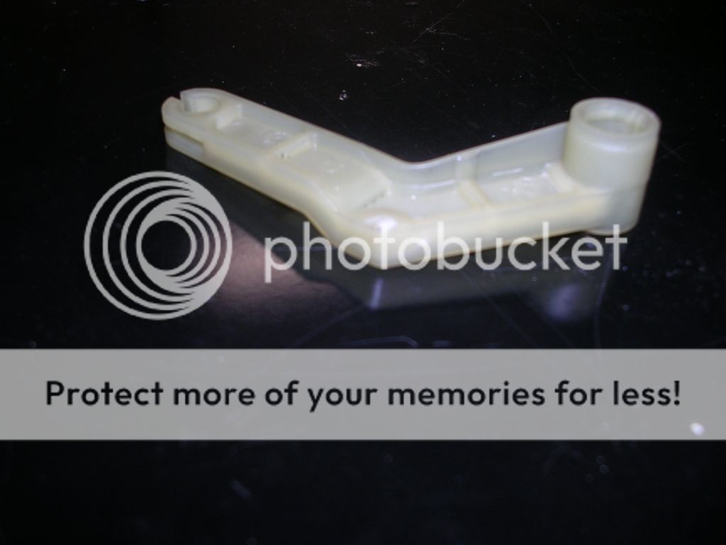

All three levers (red, offwhite, and green) run on pins in cams on the directional control (red and green) and the heat control (offwhite). The pin was broken off the offwhite lever at the bend:
Also, the red lever was not sitting all the way in, so its pin was disengaged. The red one would seem to be the one that sends air to the defogger vents. The green one would appear to control the floor or upper vent choice.

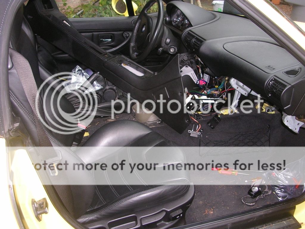

Here's where it sits right now until I hit the parts guy at the stealer tomorrow:

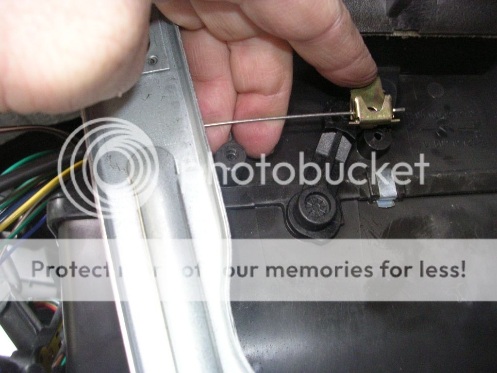

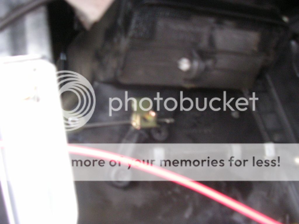

Got it back together today. Here's the basic problem with the cable adjustment. The cad plated bit should be centered on the top of the black arm:
It's a tight friction fit on the cable. I was able to work it down a bit and now the dash control can go all the way to cold. I moved it a bit further, actually, as the flap sticks when closed and that may have caused the OG pin to break. As I understand it, there was a foam gasket and either it deteriorates and the old adhesive causes the flap to stick or it just turns sticky itself. So now it doesn't close all the way, and there's no sticky spot coming off cold. Here's the result. A couple zip ties were added as safeties to keep the adjustment:

Hi, looks like iv got to practice my yoga ‍♀ moves. Is it a possibility that the fault might be at the bottom end of the cable, shown on the last few pictures.

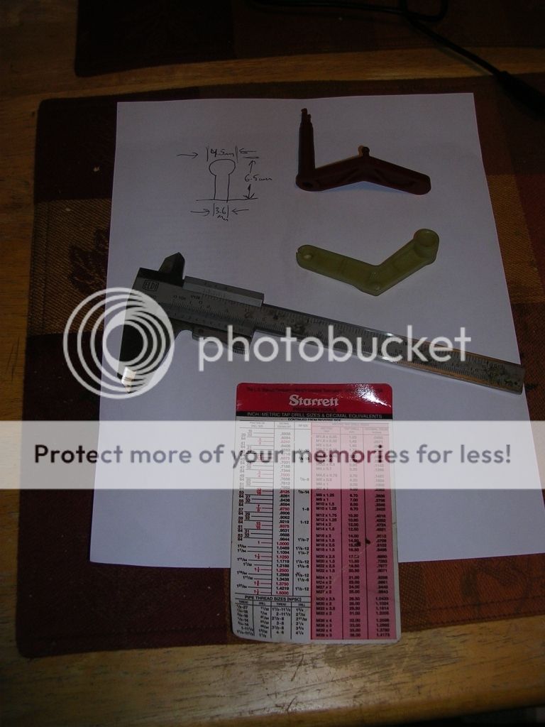

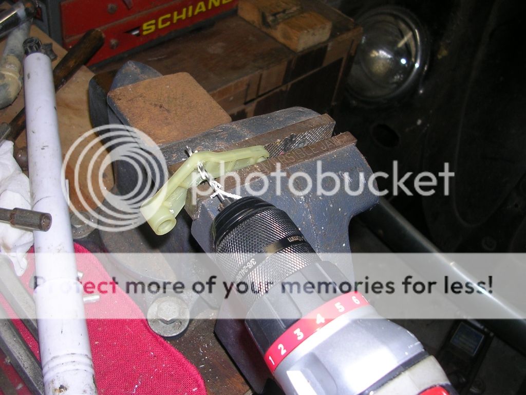

Went to the dealer, and the lever arm was not available except as part of a $200 HVAC control box. Same story at my foreign FLAPS. Screw that. Time to make the old arm work.

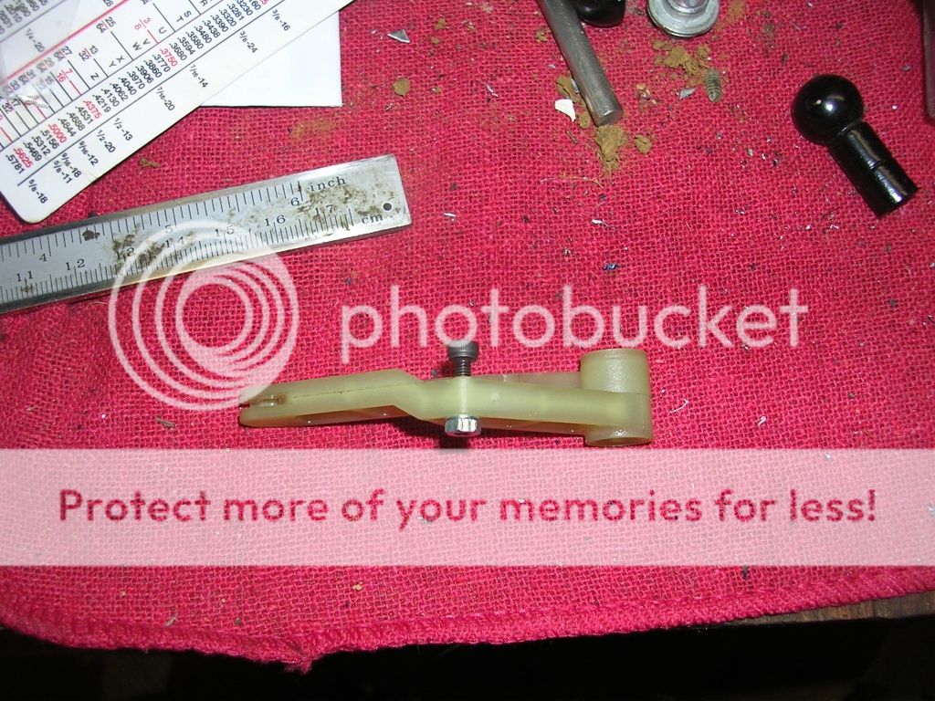

First I measured an existing pin, and wrote down the details:
Thence to the hardware store to find a substitute item. Once back home I drilled:

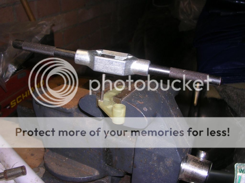

And tapped:

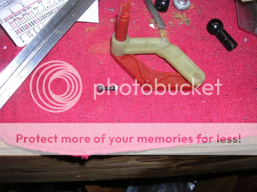

To make a home for this:
Like so:

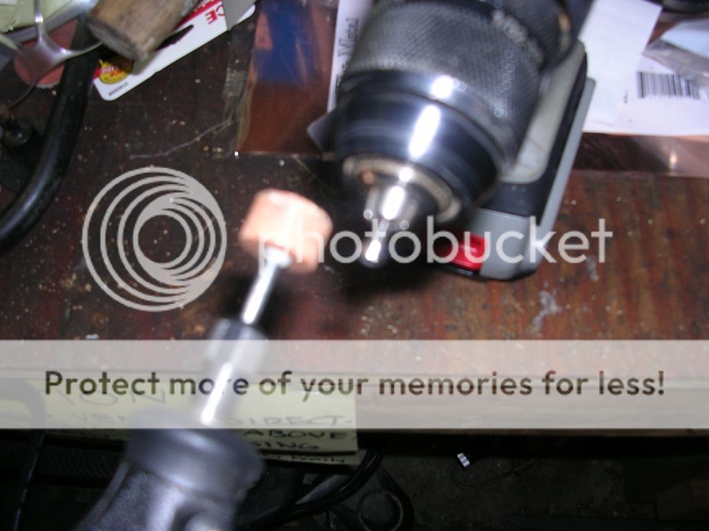

Unfortunately, the head was 1 mm too big, so I had to turn it down. I chucked it in the drill and ran the Dremel with a stone bit in the other direction:
Once down to size, it was time to try it in the control box:

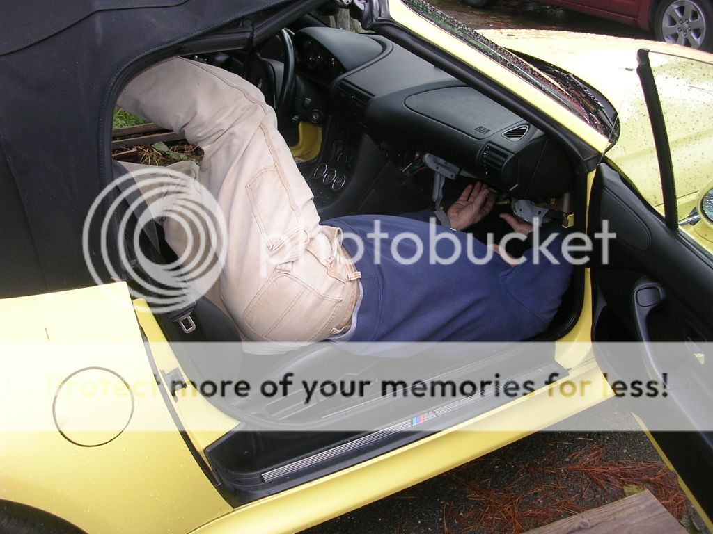

It's about 99% successful. The head of the pin didn't quite end up in the right spot, so the flap is closed a bit before the dial gets all the way to closed. I'll need to make some cable adjustments when we get some dry weather before I reassemble the dash. Sticking my head in the footwell to accomplish this will be a lot easier if I can open the top. Yoga continues to pay dividends on this job.
