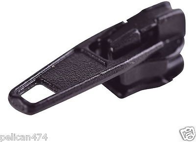

I would suggest suggest purchasing one of these
but have a shop about as that seems pricey for what it is. You will need to check the integrity of the material surrounding the zip itself is not rotten and going to pull away.
Just found on here you need a YKK No 5 Zipper it’ll be cheaper than a tenner. There is a guide on here somewhere for fitting a two person job makes it easier.

Thanks for the tip
So are you saying I'll need to remove the window and start again, no way of re-zipping the bit that's unzipped itself ?
I gave it a little pressure and it seems to want to unzip more as I push on the window next to the zip.

Eventually got around to taking the hard top back off and doing the soft top window.
Actually was not too difficult.:)
As the window was still in place the wife and I teamed up, one on the inside, one on the outside. I put the Zipper puller back on the open part of the zip, and slowly we went around the window, with a plastic tool in front of the zipper opening it up , as the zipper came along about 50mm behind, closing it back together again.
All the way round, then stitched it over the start/finish of the zip. Lovely job. Whole thing 15 mins;)
