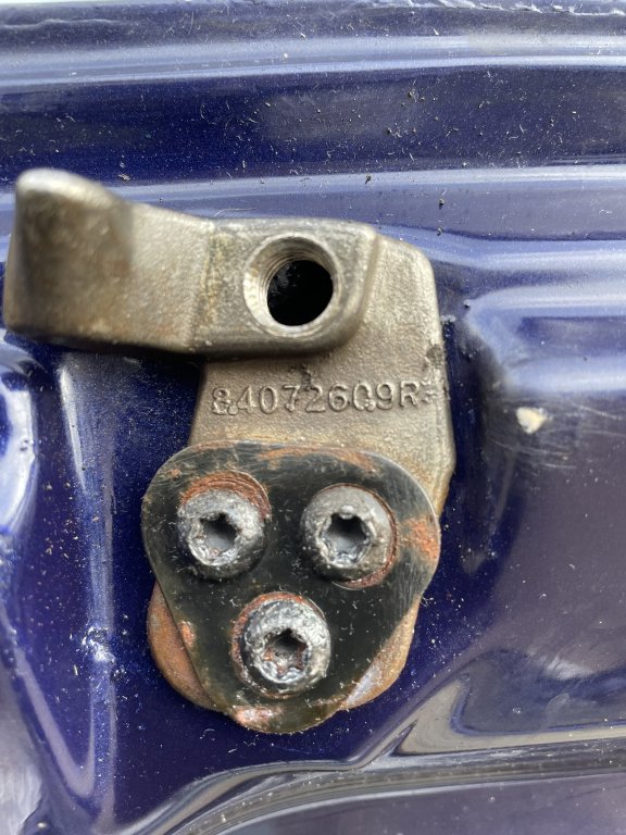

fitting my recently acquired hardtop for the first time (no fitting kit came with it, but I managed to acquire one) and the holes into the front metal baseplates are much bigger than the standard M8x18 torx bolts as you can see from the pictures of what should fit.
I’ve ended up having to use the much larger one shown in the picture which I think are M10 or 12
they are not a great fit and stick out through the bottom hole of the plastic where the bolt hole is. A bit reluctant to screw them in too tight as they are just chewing through the plastic round the top of window frame as the head is too large to fully go into the hole.
Just wondered if BMW made two different size fixing plates for the front of the hardtop?
realoem shoes the baseplate part number as 8407259
but as you can see from the pic my baseplate number is 847260
anyone else had this problem, and know which bolts I should purchase?
muzza289
Dec 16, 2023
13
Right, I can’t edit the above post, but it’s obvious to me now that **59 and *60 the ending two numbers, are left and right baseplate!
so it’s not a part number Issue. I appear to have genuine BMW baseplates just the holes are much bigger ?
