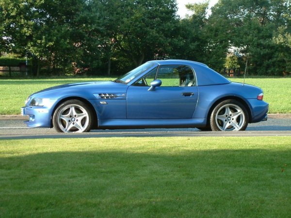

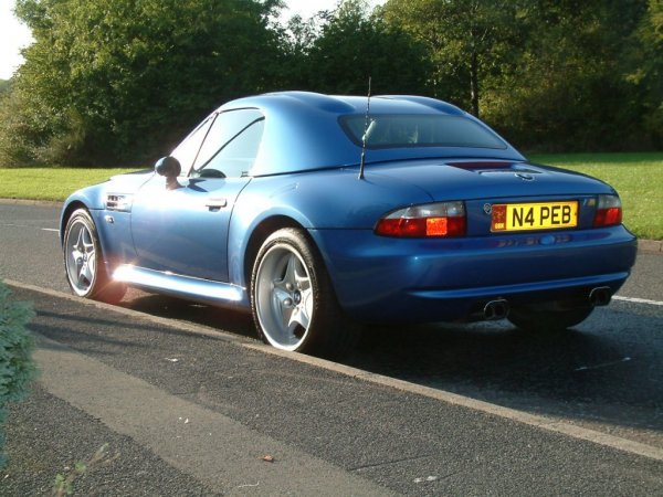

Jonno B & Michael Burridge cover what you need to do re detaching the top within their posts above.
NB: If you don`t wish to have 2 people physically lift your hardtop off your car, then have to carefully store it somewhere, consider fitting a hoist in your garage. I have such a simple, purpose built hoist fitted in my garage, operated by manual pulley, like raising a flag or a sail. I simply drive into garage, lower the windows, run the padded bar of the hoist through the windows & reattach to the pulley, unclip the hardtop as described by others above, then hoist it up clear of the car into the garage roof space with 3 or 4 pulls on the straps. A 10 minute job I`ve been doing every year for 20 years with no mishaps. Cover the hardtop with a large sheet of plastic until next needed, usually winter. Similarly easy to drive under & re-fit in due course. As it happens, I am just about to sell this contraption, as well as my Z3M Roadster hardtop, as the Z will remain `topless` & fully off-road from this winter onwards. For anyone interested, the hardtop is a spotless & striking Estoril Blue Autovogue `special`, made specifically for the early Z M Roadster, with 2 front to back blisters & a narrow solid heated rear window. I can provide more details/photos to serious enquirers.

Yeah, well spotted! A Hamann Speedster blistered hardtop, fitted by Autovogue about 20 years ago, along with some nice colour-matched Hamann nacelle driving lamps in the front air dam, giving my early ZM (1997) a really unique look, that still has people asking "what model is this?" in car parks, or having pulled up alongside from behind. Dead easy to `drive-in` clip on & off though & hoist up & down into the garage roof space. And still as spotless as it was in the last millennium! :)
