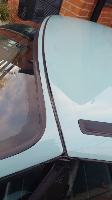

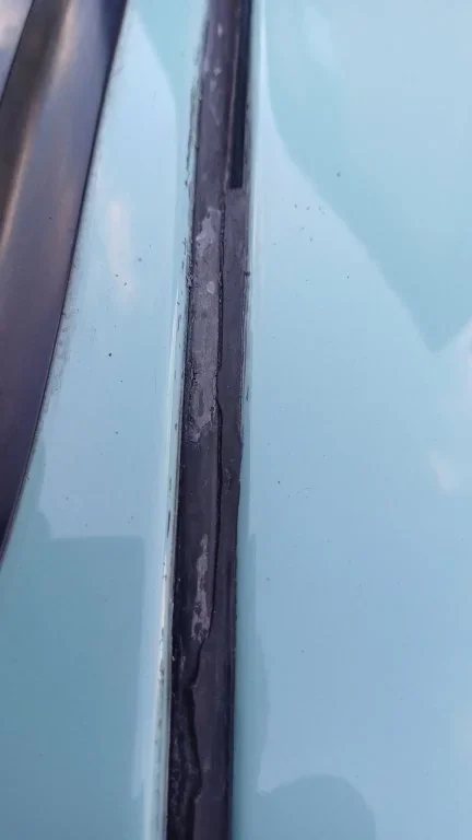

i have a hard top, and on the front edge where the windscreen molding is, there appears to be a rubber seal along the hard top, which over time has degraded to nothing.
it looks only like a 5mm strip of rubber glued to the lip, but cant be sure,
can anyone confirm this please, and if i do get more how and what do i use to glue it please.

My hardtop doesn't have that.
Is it one of those house door/window weather seal/strips you can buy in b&q that a previous owner stuck on?
Nope thats all wrong and I agree Doncodi if that is the top of the roof where it meets the windscreen then that's not supposed to be there at all. Certainly on neither of the rooks that I have (and yes I've for 1 on each of the Zeds). Can you supply another picture zoomed out a bit?
If you go to realoem. Find your car model. Go to folding/sliding roof section. See all the parts for the hardtop. There is no rubber strip around the front edge.
I still reckon it's something that somebody has stuck under tge lip maybe to stop wind noise on a poorly fitted roof.
There's rubber along the top of the windscreen frame. If the hardtop is fitted properly it's pulled down snug onto that rubber and an extra foam/rubber weather strip on/under the front lip of the roof is not necessary.
Yep is def wrong somehow….

iv been looking at the seal and its not something that supposed to be there, its bolted tight down in front corners, and pulled tight at the 2 rear, i have no issues at all with the soft top fitment, no wind noise, so you were right i suspect this rubber strip is clearly retro fitted, once i get the roof inner liner back from trimmers, i will be having a propert look.
