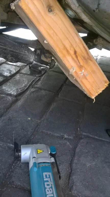

They looked absolutely fine but @t-tony showed me how much the front wheels flexed and apparently It's down to worn control arm bushes,at the rear of the arm.
I was surprised how bad they were when I was able to easily separate the mounting from the rubber inner.
I watched some clips on line on how to change them and some people opted to burn the rubber out with a blow lamp,some people used lump hammers and chisels. I didn't need to do either
Once the bracket is off you're left with the rubber inner stuck on the control arm. I used a multi tool to cut through it with ease,it has a metal sleeve on it also but once a cut is made it seperates and slides off.
Then the metal collar has be removed from the inside of the bracket,I used a hacksaw to cut a slot across it and then used a hammer and chisel to ease it out.
A quick run round with some abrasive strip before popping in the new bush.
