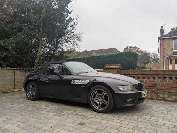

Hi everyone,
Sadly I'm having to say goodbye to my 1997 Z3 1.9L Roadster.
Currently having issues around getting power to the starter and according to BMW the issue might be due to a faulty immobilizer.
With the lack of space and family growing is no longer viable for me to spend the time needed to get it back running.
kills me to see it going but I would be happy to pass it on to a Z3 lover like me and hopefully see it running again and enjoying lots of more miles.
If anyone wants or know someone that would like a project please feel free to contact.
Thanks & Happy miles.
