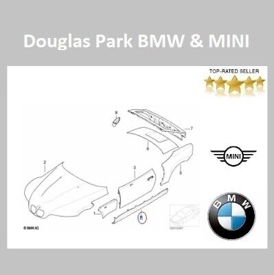

Decided to replace the sills in the end with new BMW ones. Coated up the interior of them with stonegaurd and will Waxoil
£362 delivered
