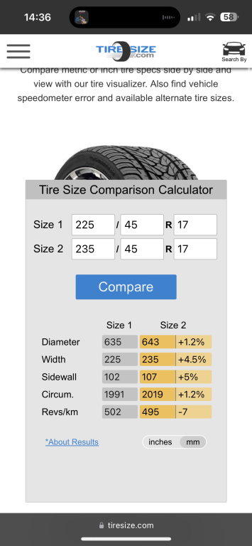

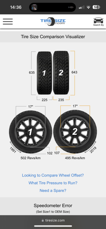

Now 225/45 is too skinny for the rear - as it is the 235 is pretty skinny.
I believe one can’t properly mount a 245 on a 7,5j rim (need at a least 8j for that).
So I’m considering 235/45.

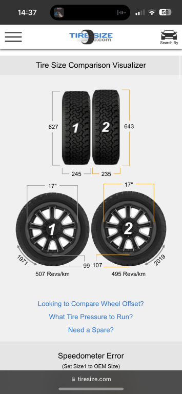

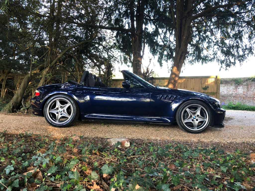

235/45 vs 235/50:
Not that noticeable in these pics, more obvious in person but didn’t look wrong at all.
