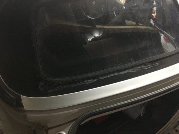

Bloody hell, someone made a mess of that, most glues are solvent based and can be broken down using the correct product, I have a spirit wipe at work that deals with most, some take longer then others, if its super glue there is not a chance of removal, if you can get your hands on some cellulose thinners that may work, you could even try petrol,
If its rubbery to the touch there is a good chance it will come off, if its brittle its more then likely a 2 pack and will not soften
