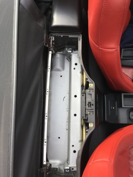

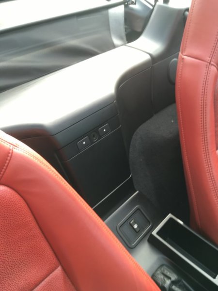

Got rid of my rear compartment, then built and fitted this:

Thanks Jim, mine Z3 never had a sub so i will be starting from scratch. Everything online shows those replacing the HK sub for a replacement like yours however mine was never there.

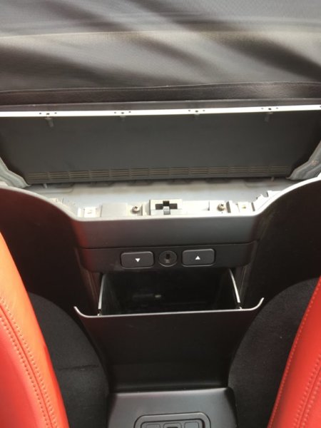

I have a cubby hole about twice as wide as yours and has another little one where the sub grill is on your car.
I will have to think some more.

Mine is the same as yours at the minute buts thats where I will be fitting the mid range speaker, probably a 6" Lanzar, you can source the mesh grill that replaces the front cubby

All I will be doing is making the box that fits inside the main cubby and fitting the grill over the speaker, like the one in the bottom pics but without the top speaker as I will be facing it forward
Will you be retaining the lid ? I imagine it will need to fit behind the cross beam that runs the width? If it does then I guess that bar in the way could reduce performance
Not quite sure yet as I need to have a good look at it, the sub has to be slimline and the Lanzar is apparently a very tight fit

Mine isn't as wide, as I have the roll hoops installed.
I didn't have a HK system. Originally mine had the upper and lower compartments.I removed all of the compartments, and installed a MDF box that I custom made (actually got another of these - and might make some more) in the top section. I made a port for the box in the front (aimed at where the lower compartments were). I then removed the lower compartments and fitted an OEM sub grill that I ordered new from BMW.

The sub box is rather heavy itself and is a snug fit. It's basically wedged in with some foam underneath to reduce any vibration. It works great for me and had it in for about a year.

As @Sean d says i built a box and have it forward facing as wanted to keep it looking stock.
I run a dual voice coil Kicker sub ,which delivers alot of mid range punchy bass it drops quite well for its size but will never compete with a larger sub.
