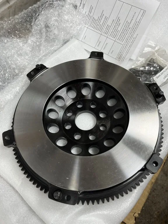

I got one of these a few months ago, an XTD from the States, takes a ‘96-99 e36 spring clutch.
45% lighter than the 6cyl clutch the blurb says.
I have the M44 4cyl, I’ll be having it, and the cover, balanced to that.

It looks like most of the 45% has been removed from near the centre. That will have a very small effect compared to any weight that can be removed from the outer edge.
Every little helps, but make sure you know what you are looking at. A lightened clutch does not have to weigh less, but the "point mass" will be closer to the centre.
This is why Formula One clutches look like more like a bean can than a pizza, but the bean can and the pizza could both weigh the same.
Not my first lightened ‘wheel Pingu, most of the mass is off the rear face, I may have a little more off the outer edge when I have everything balanced, I’ll consult the guys at West of Scotland on that when I’m allowed to drive again.
Oh and I missed out most of these US off the shelf ‘ wheels are designed around the 240mm ‘96-99 M3 clutch.
