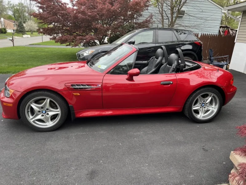

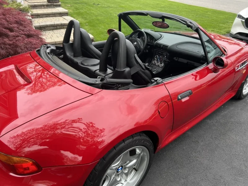

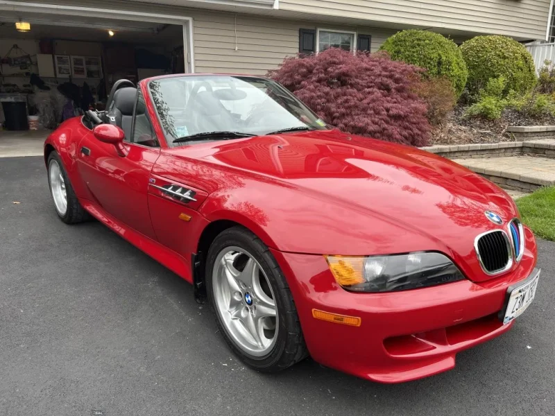

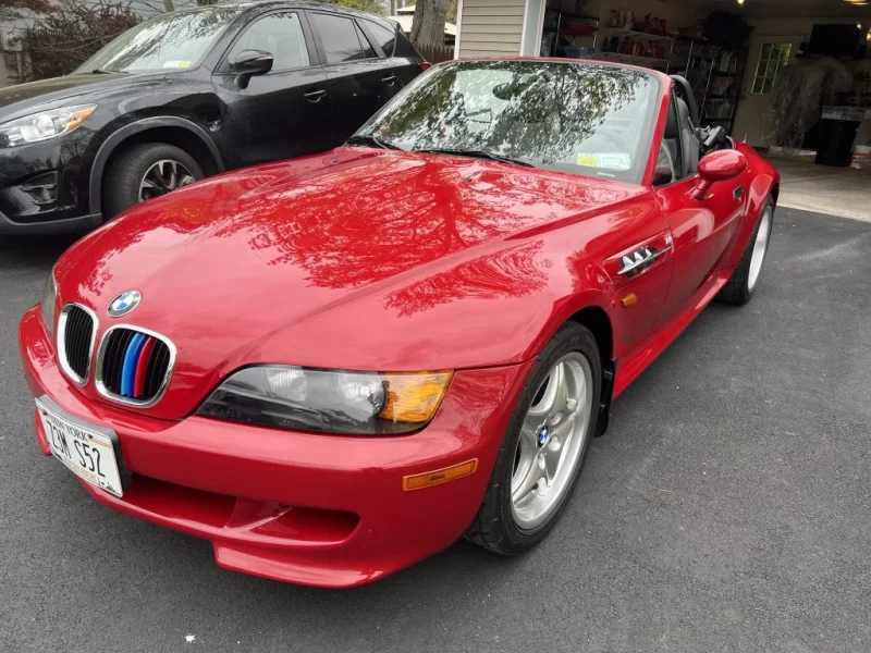

Did a color correction….very happy with results
1) Dr Colorchip
Wash/Claybar
A) Meguiar’s Ultimate Compound using-Torq10FX Random Orbital Polisher
B) Mothers Pure Polish -using Torq10FX
C) Mothers Micro Polishing Glaze using Torq10FX
D) Tried Wolfgang Concours SIO2 instead of wax
Got out most of the swirls…was lots of fun
