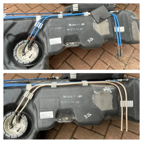

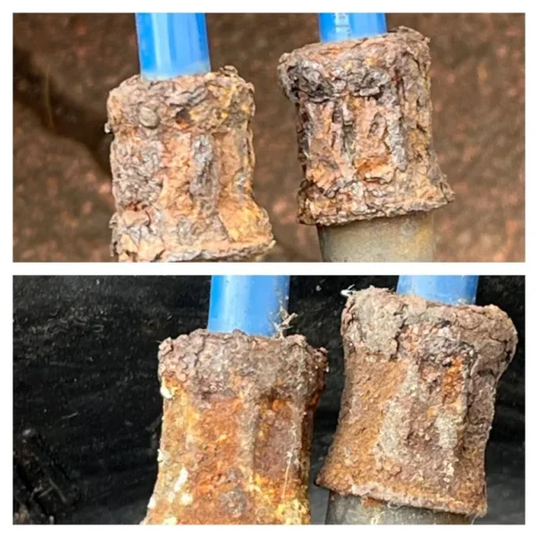

You can access them, but they clip into the top of the tank and you can’t access those without dropping the tank. IMG_4679.jpegIMG_4680.jpeg
I replaced mine with kunifer because the condition of the metal ferrules scared the life out of me. New originals are available, over £200 I think, the kunifer I already had.
Fuel pressure is generally around 2-3 bar on most cars, more than enough to create a big problem quickly.

Brill info thanks Iain
The pictures really help
What I don't understand is why the is suddenly a leak in the pipe
A corroded joint I would get but I think there must be a whole in a pipe
