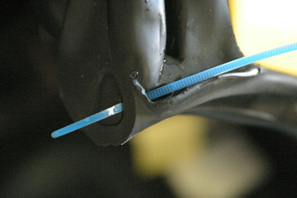

You’ll find that it’s most likely a rubber ‘bung’ part at the top of the A pillar that is most likely the cause of the water ingress into the car.
To get to this you need to remove the hardtop.
The picture shows how the water gets in. The rubber bung should be sealed. 2 options, either buy a new seal or get some sealer to seal the bung back in.

BTW , I have checked the plugs and they are sound. It's definitely linked to that rubber 'contact' joint there. Tried earlier to pour water over it and sure enough, it gets inside due to the offset. Not sure any adjustment of the hard top will help there!
