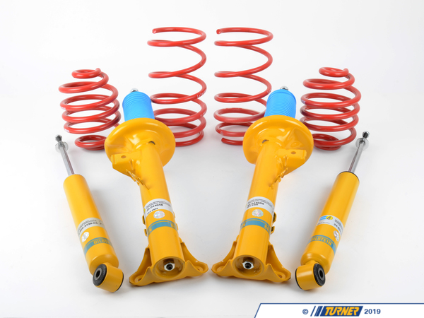

I decided to go with the above shock and spring set from Turner Motor Sport, WOW what a difference, I can't recommend this kit highly enough. It is amazing how well the car turns in now.
