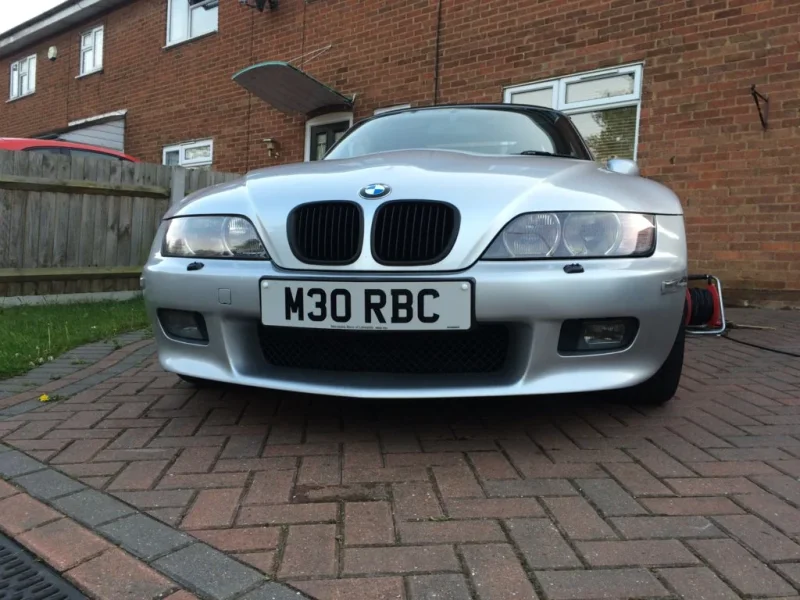

I've just done that job of removing the slatted grille, it is held in place by about 14 sprung washers (can't recall the proper name for them). These push over small plastic pegs, the washers / clips push down over the pegs easily but grip onto the pegs if you try and remove them. I used two small flat screwdrivers on either side of the washer/clip to lift it up slightly just enough to get a pair of pliers on, then you can effectively 'unscrew' them off the plastic peg. These pegs moulded onto the bumper cover are easily broken so do not try and lever the clips off completely but just enough to get a pair of pliers on to unscrew the clip off the peg. I removed all the fastening clips without breaking any of the pegs. The sensor you mention is the outside air temp sensor, on 6 cylinder cars it is on the offside of the grille (just pushes in/out ) and on 1.9's it is on the nearside foglamp plastic trim panel.
