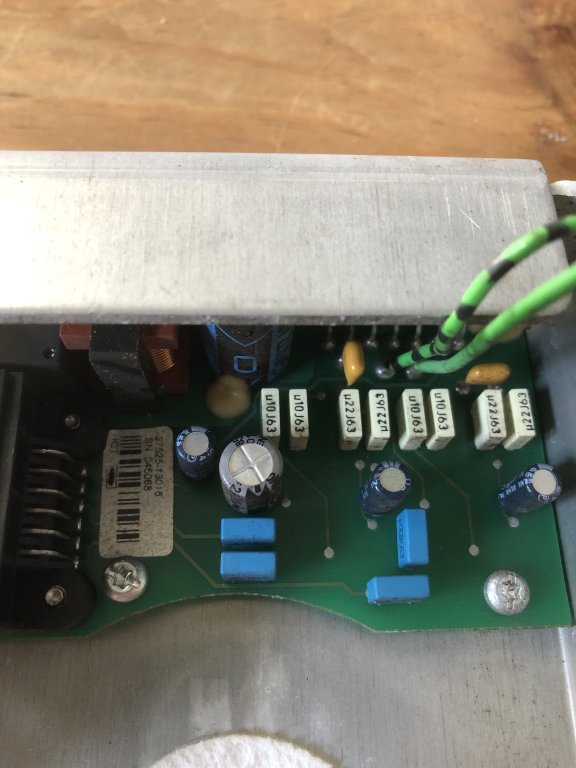

The speaker in the passenger footwell seems to click on and off ( almost sounds like a relay latching)
There is a main power relay on the AMP board. They do loose their "sticky" and start opening and closing on there own accord, due to the close proximity of the speaker magnet. I've replaced then in the past and the AMP has continued to function normally. Not a big job.

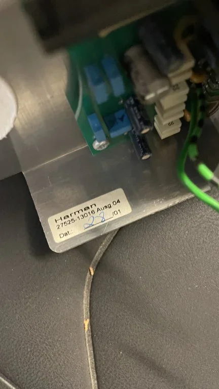

Yes. It's the blue rectangular box. Get the type details off it and you can buy them.

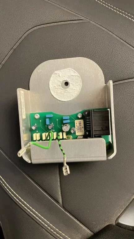

Following with interest as I’ve noticed my footwell speakers or at least the drivers side is working very intermittently. Plan to remove the covers and assembly and see whether dodgy connections are the issue.

Find pin 5 on the amp connector. Trace that track to the blue relay that needs to be replaced.
Sorry it's been 8 years since I did the last one, so can't tell you by looking at the photo. Memory fade.

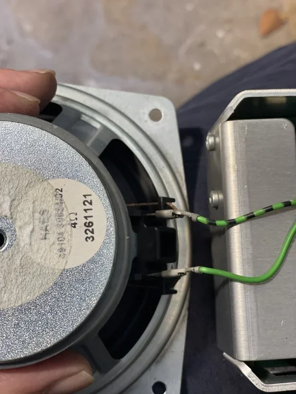

Hey, cannot tell on my speaker wire which is positive or neg as they are both completely grey . :confused:
