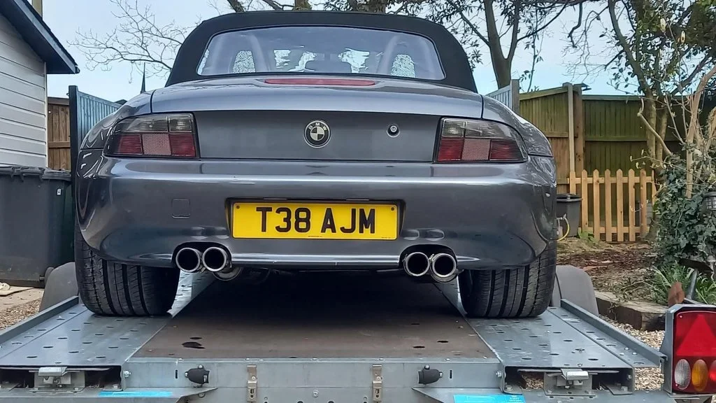

For the cost of fitting an A frame would it be easier and simpler to pick up a used car trailer? That solves all the issues with brakes and wear on the car itself.
When I was getting my car running I was lucky enough to barrow a trailer from a friend to tow it back and forth to the dyno.
