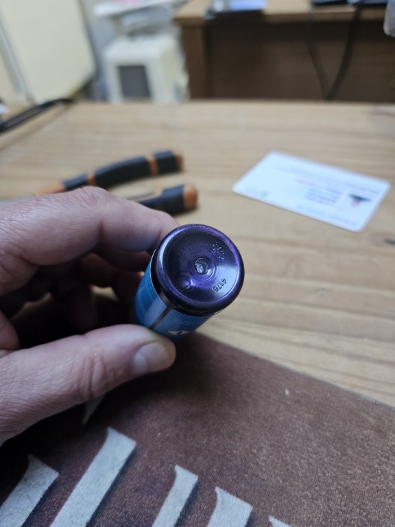

My Chipex paint arrived, cleaned the car, opened it up and it was purple! Put a tiny bit on the car to send a pic to Chipex but if they offer a 100% colour guarantee and sterling grey is the new purple I am going to need a lot of little bottles! :) Has the right paint code on the bottle and shook it to make sure pigment had not separated.

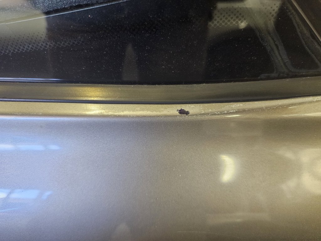

Had a go at this little scratch yesterday
Masked the area then a very gentle sanding with 3M 2000 grit wet and dry to take the edges off the scratch. Cleaned everything with the blending solution from my chipex kit.
Paint (which I bought from eBay) dabbed into the scratch using the corner of a business card..loads easier than a brush
Let it dry for a couple hours then another very very light sanding using the chipex blending solution as a lubricant for the wet and dry
Quick once over with some abrasive compound then some polish
it’s not disappeared completely but with a bit of practice I think I could get it better..got a whole bonnet of stone chips to practice on 😁
