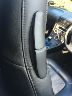

  1. Line up your seat clip and secure together with a small bit of masking tape so the edges line up. (Original before photograph 1)

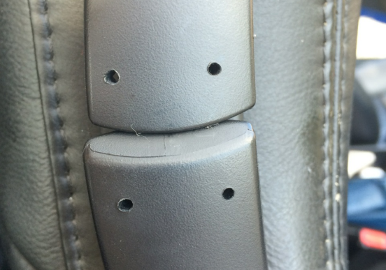

  2. Hold the ‘Z’ in place and drill through the holes so that you just mark the surface. You may wish to remove the seat belt and tape so that you don’t damage it when doing the following. (See photograph 2.)
  3. Remove the ‘Z’ and drill the holes at a slight angle so that the screw hole is square to the surface. Now remember to replace the seat belt back into the bracket. (See photograph 3).

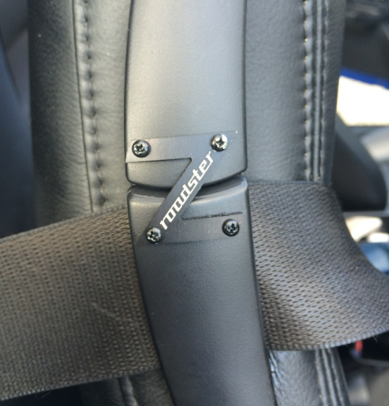

  4. Place the ‘Z’ in place and carefully by hand screw into place. Do not over tighten the screws as you might end up with loose screws. (See photograph 4)
Photograph 1.
Photograph 2.
Photograph 3.
Photograph 4.
