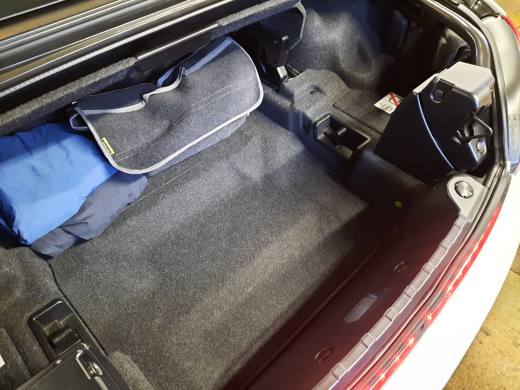

First thing is to empty the boot for ease of access to the O/S/R corner of the boot where the module lives.

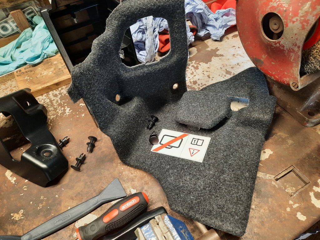

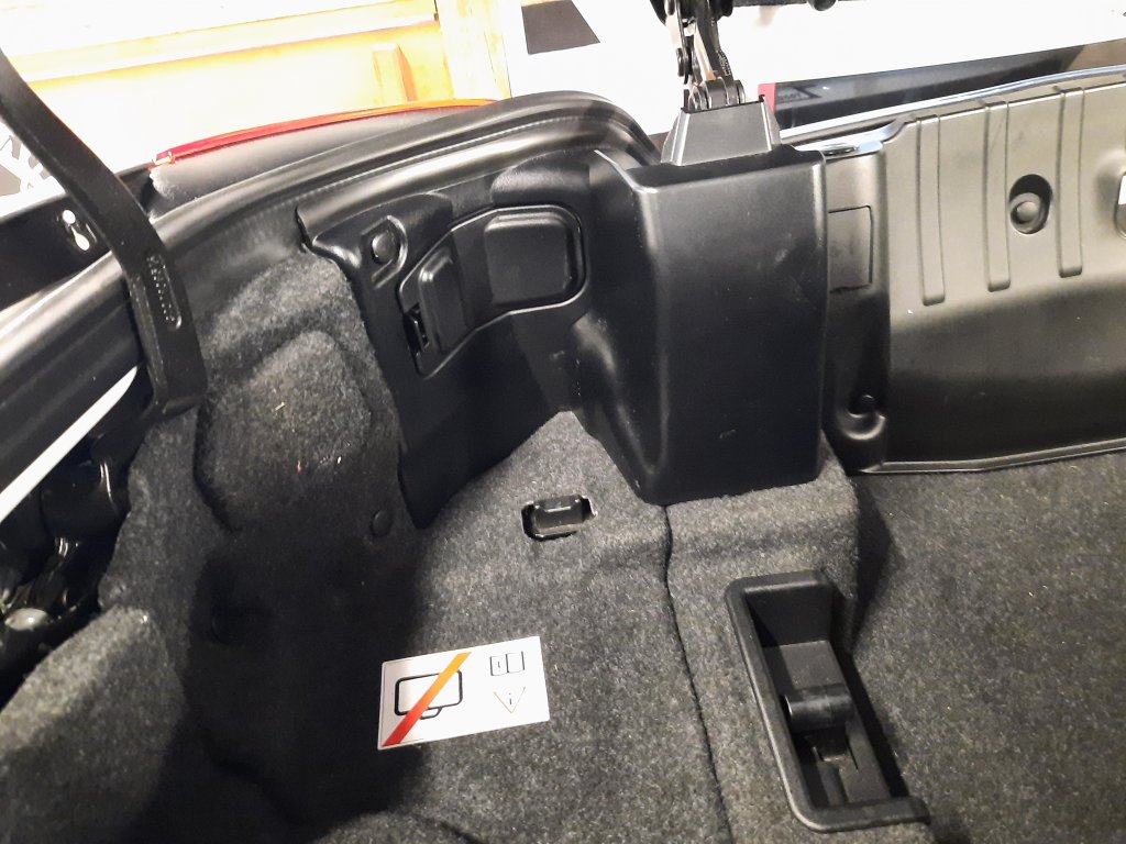

You need to remove the trim from that corner of the boot. Starting with the hinge covers, one held in place by 3 plastic plugs and one with 3 spring clips.

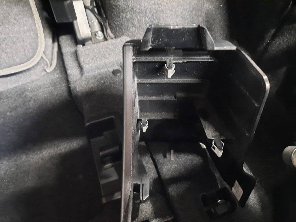

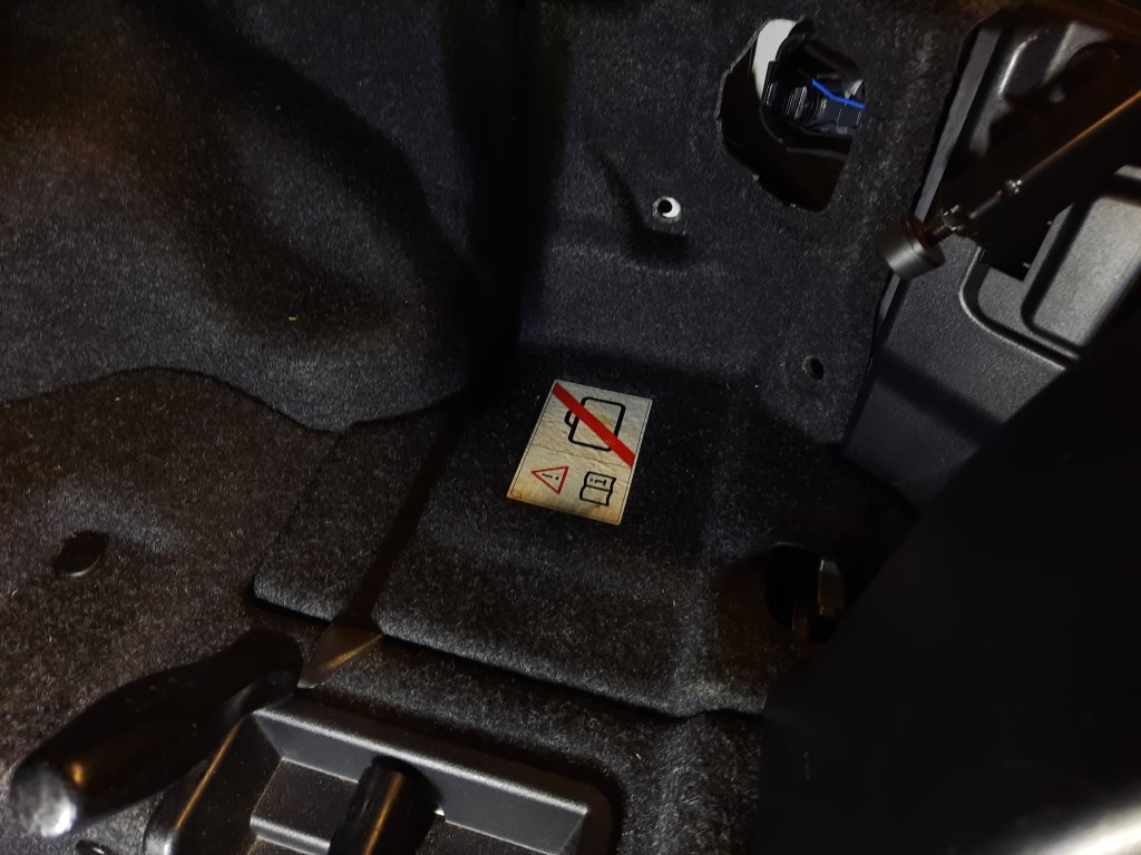

Next the trim from the side of the body, again 2 plastic plugs and 2 spring clips in the floor (see where the pry tool is located).

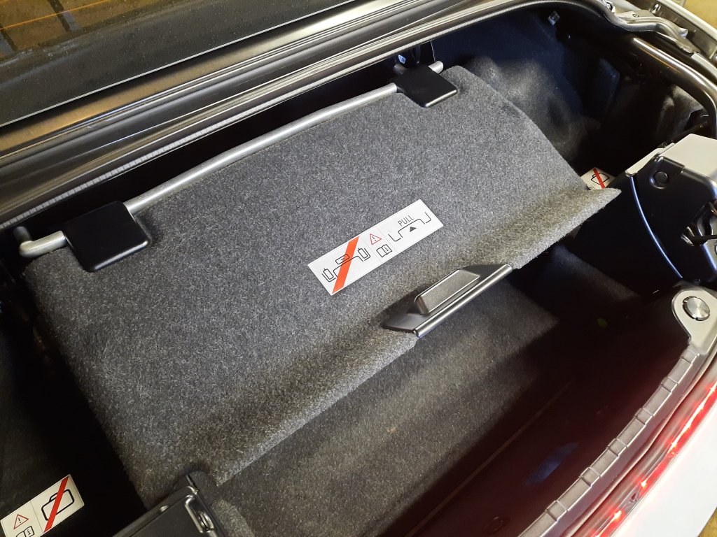

Next lower the load cover and close the boot.

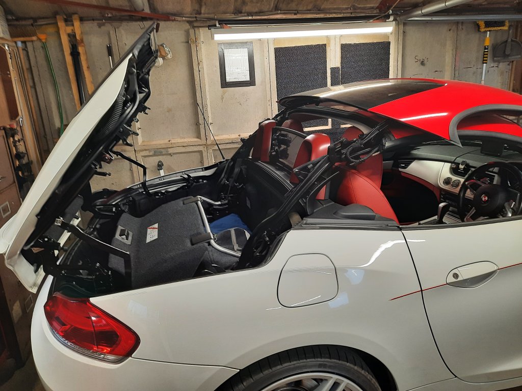

Now start the engine and press the "Lower Roof" button and hold it until the boot Deck is fully open, then release the button and switch off the ignition.

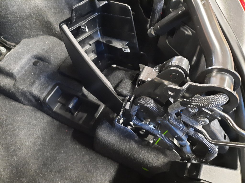

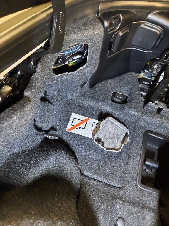

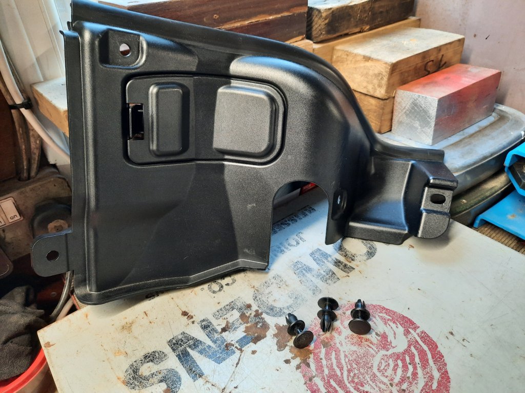

Now raise the load cover, and remove the plastic light cover held by 3 plastic plugs.
All the trim bits.

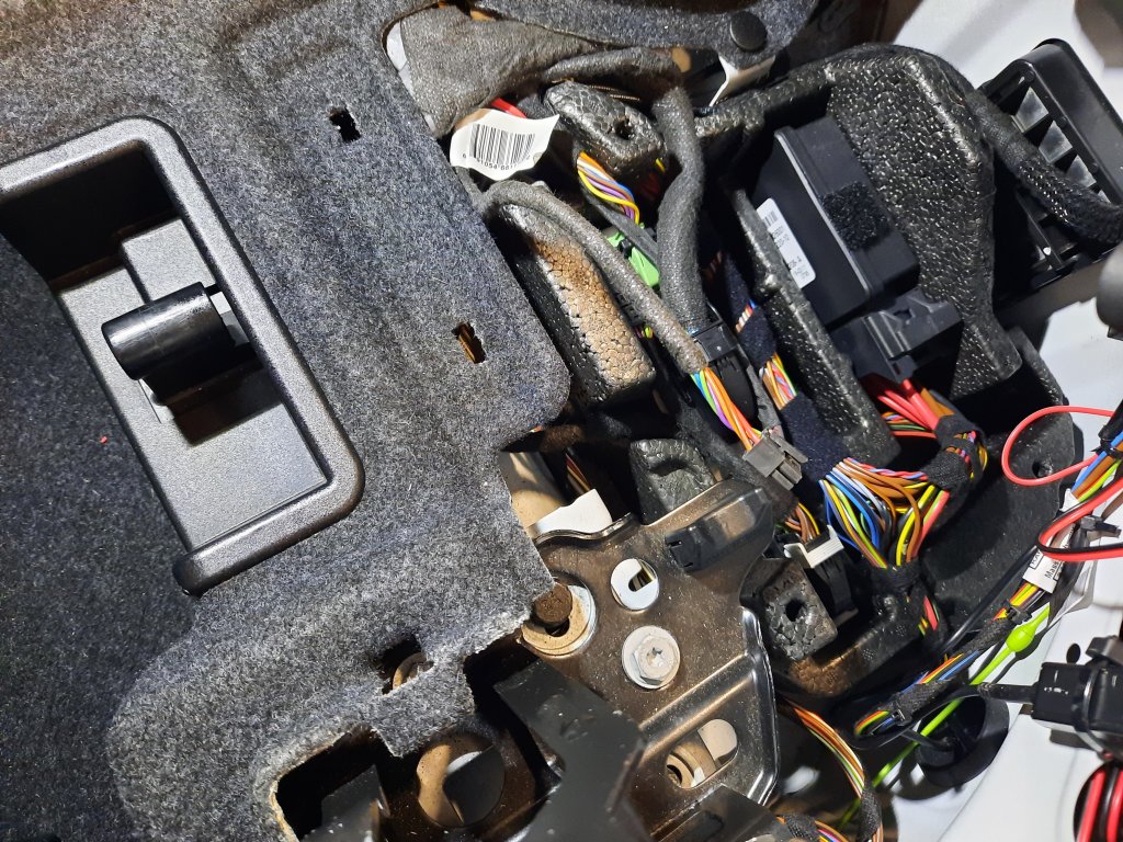

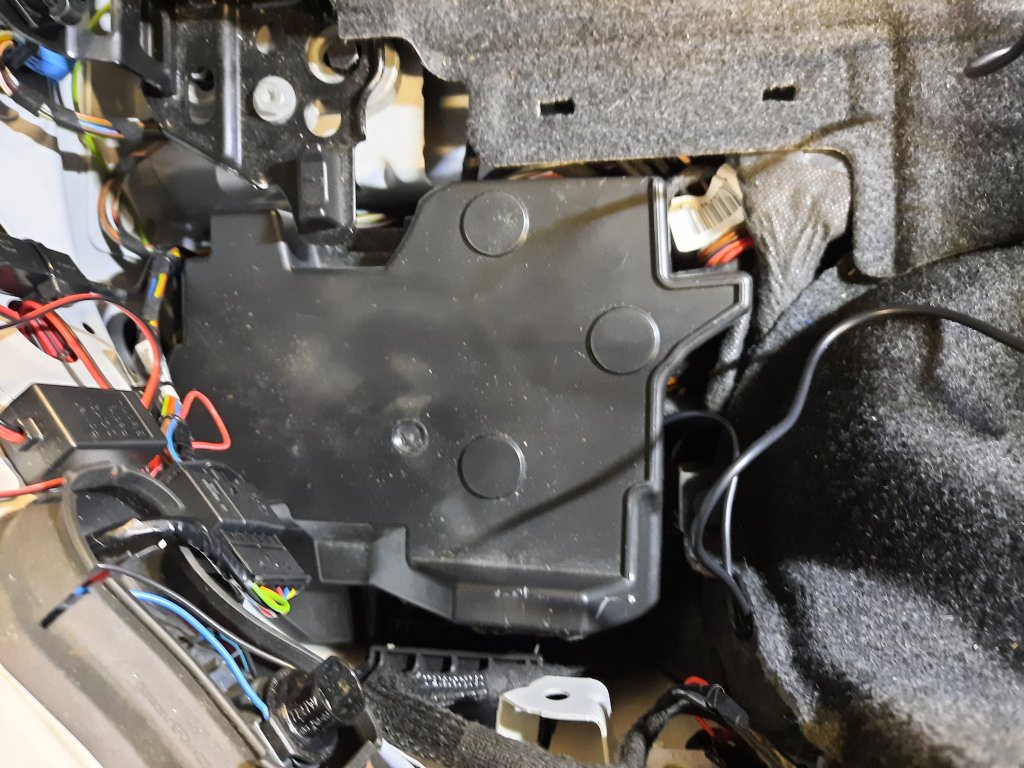

In the bottom corner you see a plastic cover which lifts off to reveal the module connections.

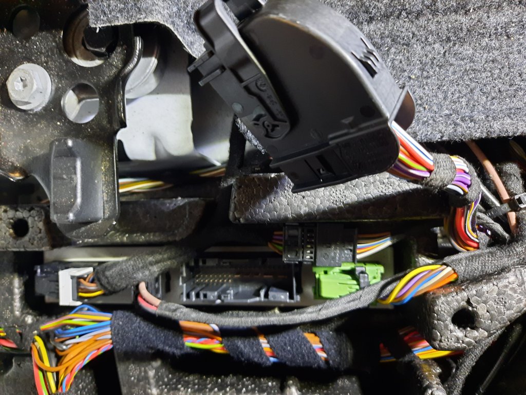

In the middle of the picture is the connector you have to remove. Press the button and move the lever to the left which releases the connector and lifts it out of the socket.
The connector which comes with the Module plugs into this socket and the original plug which you just removed connects to the other end of the new cable. This then fits nicely under the carpet out of the way.

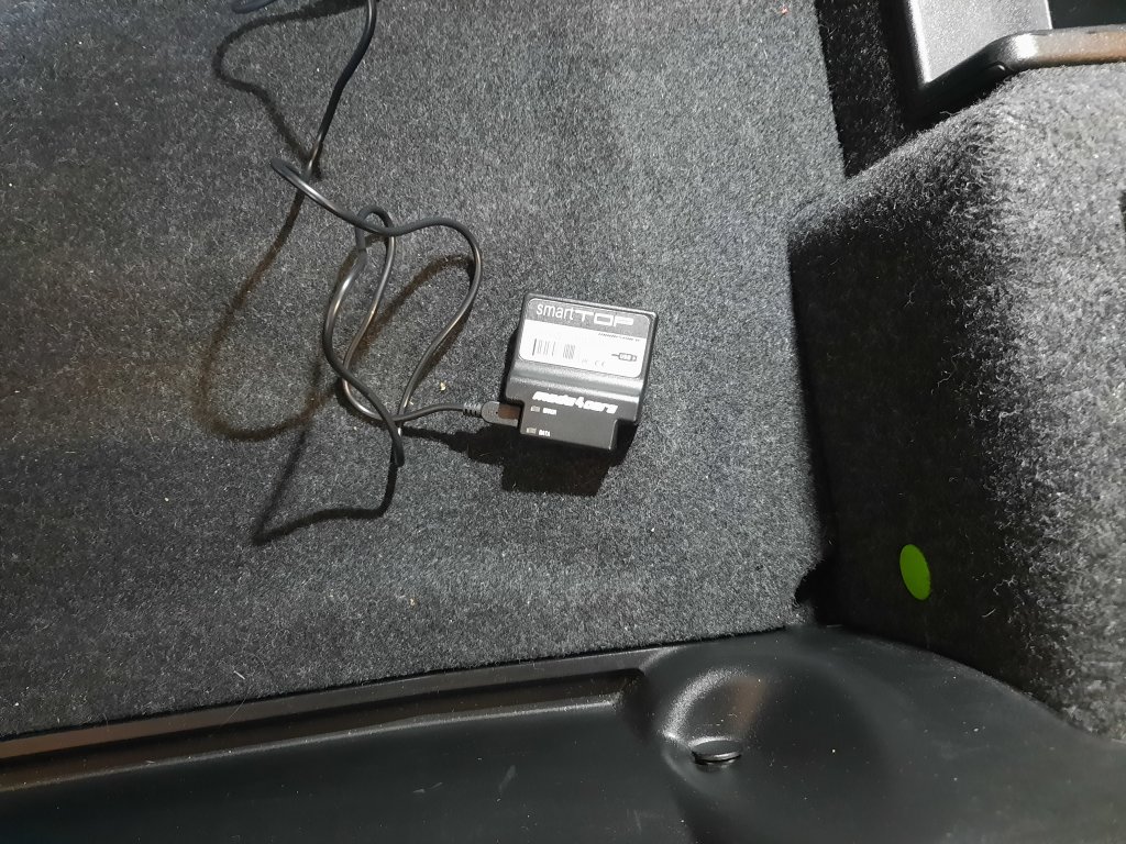

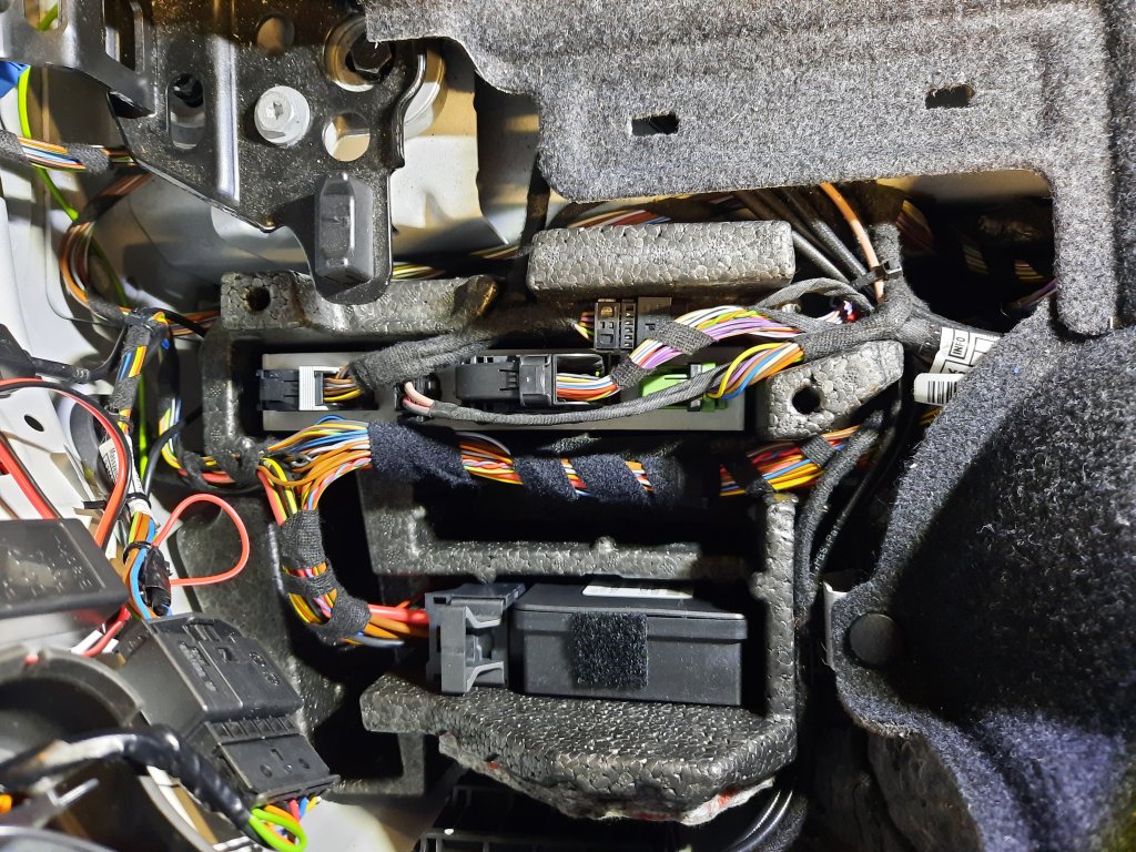

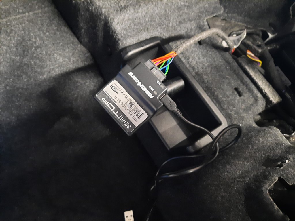

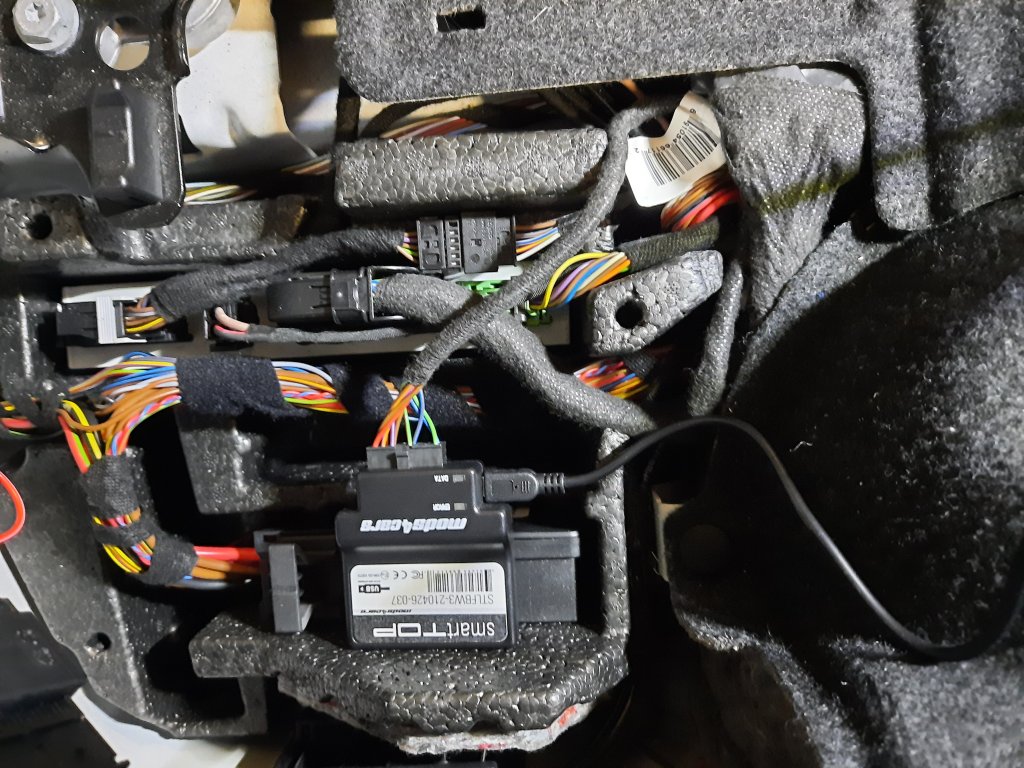

There is a "Fly Lead" from the main loom which connect into the Module itself. You cannot get this wrong, it will only connect one way.
They supply a small square of velcro to secure the Module to the casing.
Next you replace the cover for the electronics.

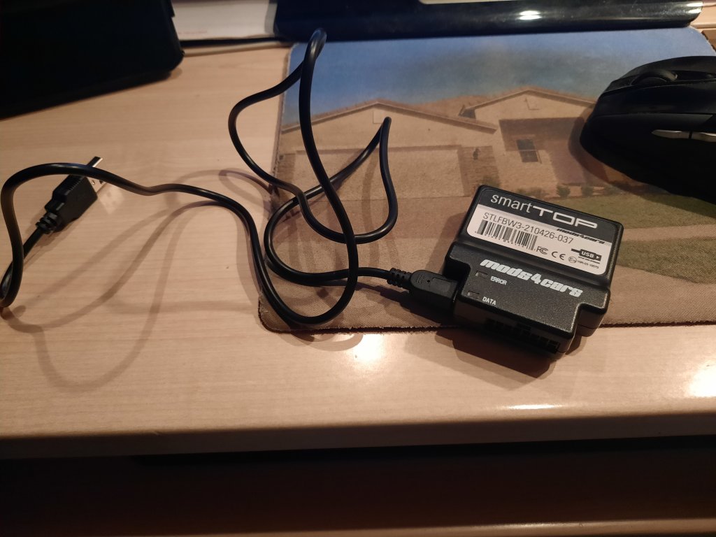

I need to alter a couple of settings in the programming, which for me entails removing the Module (only) and hooking it up to my PC. as I don't have a Lap Top. If you spotted the USB cable poking out from the trim, that is what it is for.
It will likely take you longer to read this post than it will to actually fit the Module. Any questions please ask.
To re-program the Module if you have a Laptop (I don't) you need to connect to the Module via the USB cable you left attached, but for me it means removing the Module (only) from the car. Open the roof until the boot deck is upright then stop the function. Lift up the load cover and remove the 3 pieces of trim as before. Lift the Module ( and USB cable) from the Velcro pad and take indoors.

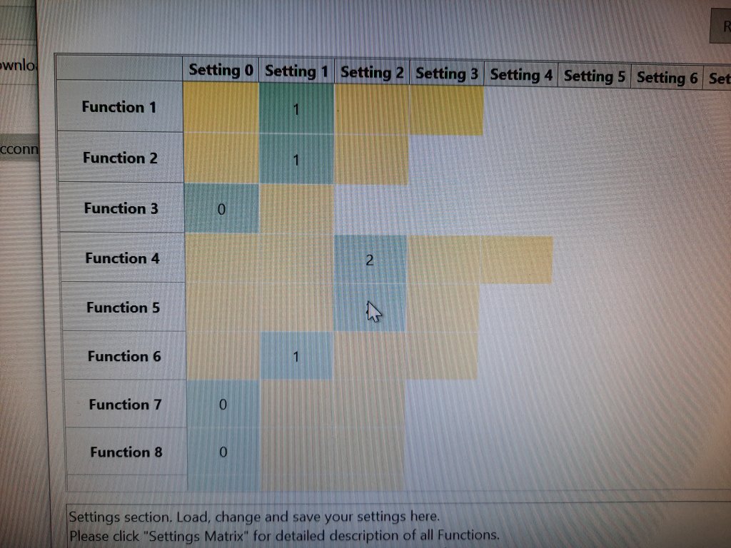

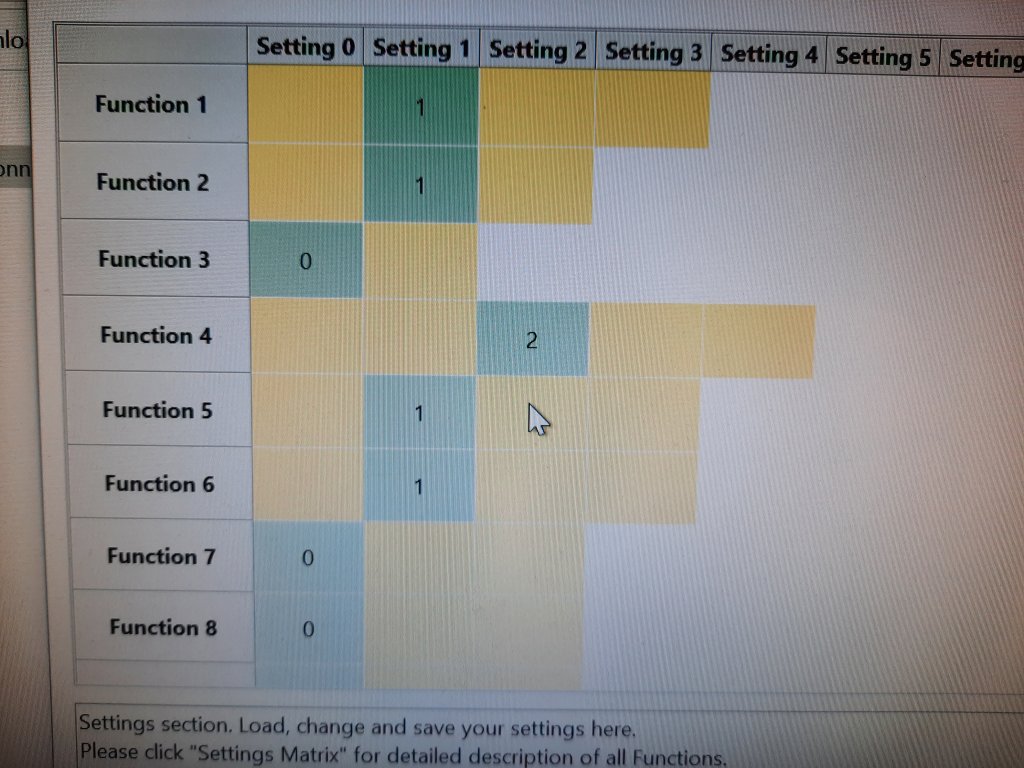

You will have the address links stored from previous set up. Go into the settings Matrix and adjust settings as required.

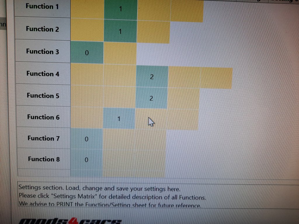

For functions 5,6 & 8 click on the Setting 2 (across the top) and you will see the tab move to the right.
Moving the setting in Function 8 from 0 to 2 means that when the roof is lowered all of the windows will be left in the UP position at the end of the operation.

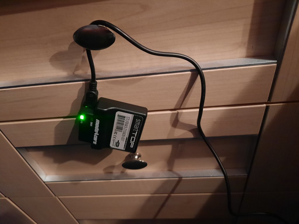

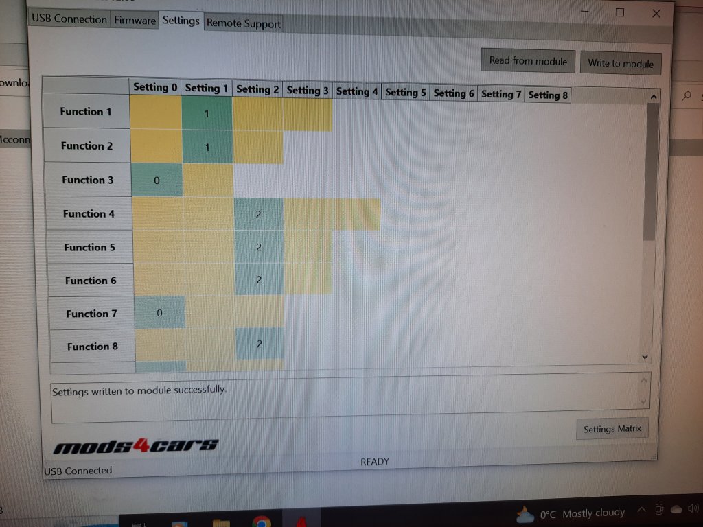

Connect the Module to the PC. The green LED will light.
In the top right corner click the box "Write settings to the Device"
In the box at the bottom will appear "Settings successfully written to Device". Unplug the module and refit to the car.
Re connect the Module to the "Fly lead" and attach to the Velcro pad.
I actually disconnected the Module and re routed the "Fly lead" under the thicker cable and round the end of the black polystyrene block so it wasn't under any pressure.
