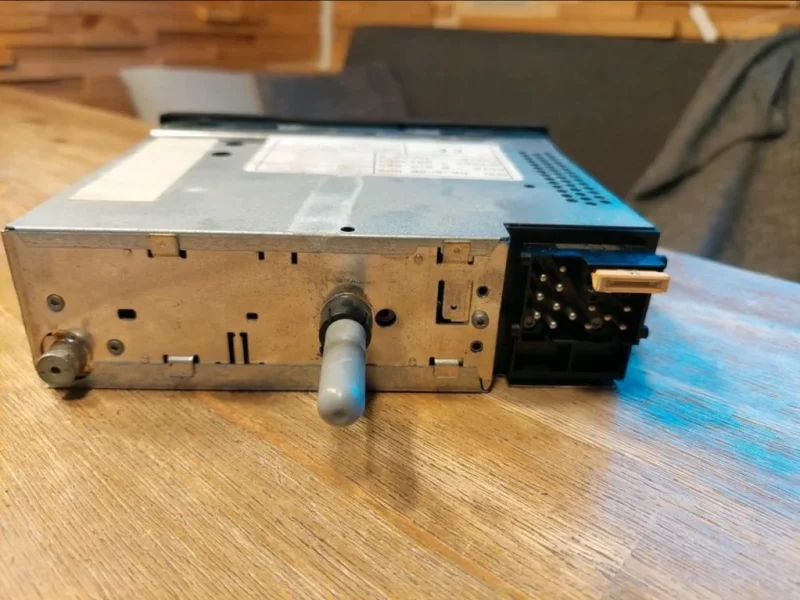

Garrie if you take the radio out and peer in see this bit here
Clips into that .
Part of the stereo anti theft system so as well as the unit having a code the pin on rear of unit engages into that switch and when alarm activated if stereo removal attempted will set off alarm.
