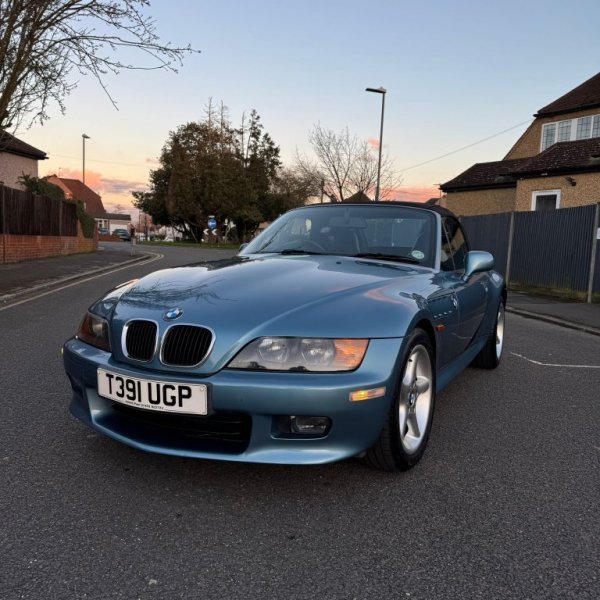

Hi
Just like to introduce myself and Z3 as newbies to the club.
I have long liked the “true” wide body Z3 (pre-facelift!) with its gorgeous curved rear quarters, and wide rim wheels all round. So, earlier this year I finally found a very late, March 1999, pre-facelift 2.8 with the improved (Edit: M52B28TU engine - not M54B28) with bodywork in exceptionally good condition and relatively low mileage @ 67k miles.
The drive home revealed a few home truths about a 25 year old car compared to our current daily drives!
The handling is atrocious! It tramlines and wanders all over the road!
There is no cruise control- I use it extensively: on long motorway journeys it makes driving so much more relaxed, whilst driving through towns with (ridiculously?) difficult to maintain 20mph speed limits, so much easier.

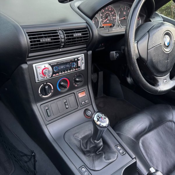

The standard leather seats are not particularly comfortable, supportive, or conducive to spirited driving.
Lacking air conditioning was a big revelation/disappointment!
We have become so used to having it that it took me back to my early days of long journey driving, with windows up, windows down, roof down, roof up , windows down, ………..

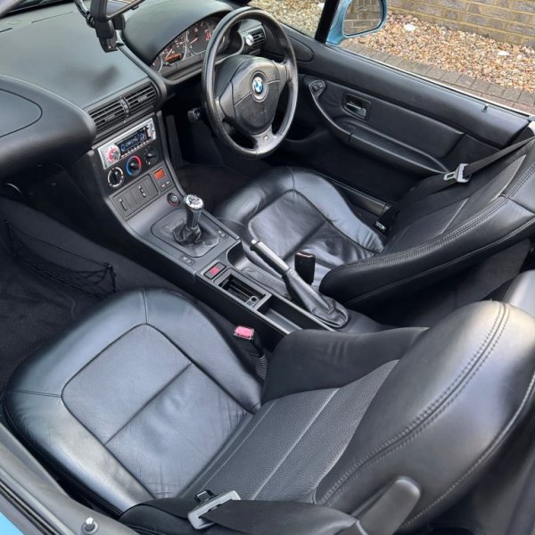

3. Swap my standard seats (despite their very good condition) for a set of M or Sports seats

Yes sports or M seats ( if you can find them ) would certainly improve the lack of support from the standard seats i have proper M seats in my 1.9 Dakar love them

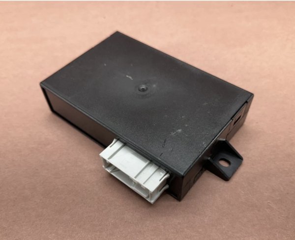

I’m sorry but your comment regarding cruise control not being possible in an M52B28TU is not correct. It is a very straight forward retrofit requiring only 3 standard BMW factory cruise control parts which are plug and play into the pre-wired existing loom.
I have already fitted them, in around 45 minutes, and it works.
So, the good news is you too can have cruise control😊.

I have bought a Z3 donor that has M seats and drove it home for 4 hours and found them to be much more comfortable than my standard seats.
The drivers bolster is badly worn, so I’ve taken it to a local upholsterer to have a new bolster sown in - and the ubiquitous broken seatbelt guide replaced.

Yes, the M52TU is drive by wire, albeit that it has an accelerator cable that links to the electronic actuator on the side of the throttle body.
Yes there are just 3 components for a manual car:
The column switch (I could only find them available used
The control module. - on EBay UK
and the clutch switch - to cancel cruise if you change gear) - again on EBay UK.

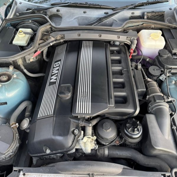

All M52TU engines have cable accelerators, but the cable operates an electronic actuator on the throttle body making them drive by wire.

After your post you had me thinking i was going a bit off in my old age so out came the torch and went for a look and can say categorically 100% my M52b28tu has a throttle cable that goes from the pedal to the throttle body and is definitely not drive by wire.
You will find this with the last of the pre face-lift and first of the face-lift models are a bit hybrid in their bits .

I will try to take a photo of my throttlebody for you to confirm it’s the same as yours.
Hi Steve
My accelerator cable to the throttle body: it does not mechanically open the throttle, rather it activates the potentiometer which then tells the throttle actuator to open the throttle.
Hence it is very easy to add cruise control to a M52Tu.
