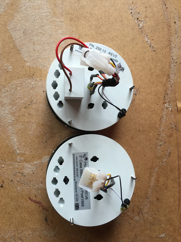

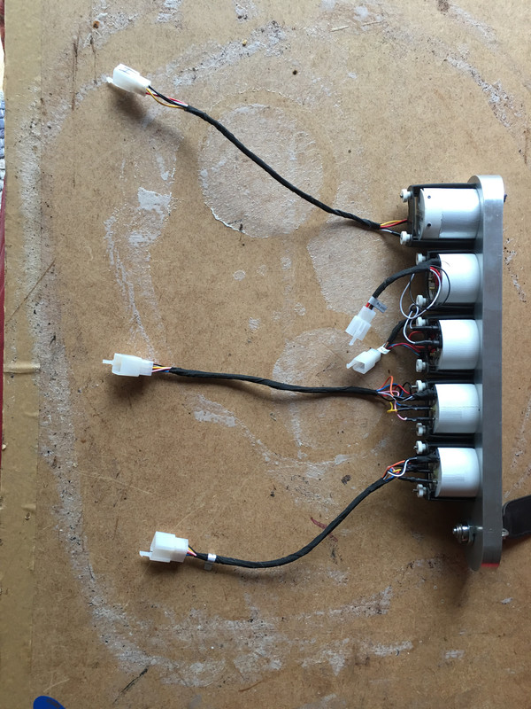

Spent a cold day on my knees outside, I managed to get the 3 PCB plugs to drop down below the steering column but there is no way that there is enough room to fit the PCB under the dash above the driver's feet. I think my dash is shallower than yours so back to plan B.
I have glassed up the demist vent so it is much shallower so the PCB will fit above the dash behind the crash bar, at least I hope it will fit.
The 5 small instruments have been returned with 3 of the tails increased to 250mm but 2 of them have been left untouched and are only 25mm long. Obviously, the maximum you can move them from the dash is determined by the shortest wire, the main loom section has been extended so I am hoping that this will give me the room that I need. Speedo and rev counter leads are still only 25mm long so again I'm hoping the longer dash loom will save the day.
If you look at the picture of the back of the speedo and rev counter you can see how many fiddly holes there are for the bulbs. You need to be able to have plenty of room to get them fitted. The bulbs are on a decent length loom but no connectors. It would have been much easier to fit the bulbs on the bench and then just connect a couple of connectors, we will see.
I know you have fitted a plate for your speedo and rev counter so you can fit the instruments to the plate and then screw the plate to the dash, I want to try and avoid this so I will be attempting to wire the 2 instruments through the mounting holes, push them into position and then try snd fit the mounting bracket by reaching blindly behind the dash, will it work? 50/50 at the moment. This problem is down to my dash design, not the instruments.
Access determined by shortest leads so only 25mm
17 bulbs to fit, made to drive you mad
