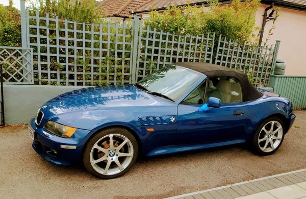

Attached is a pic of where i'm at, only thing letting this car down at the moment I think is a sealant/tape job on the mirror as they were quite expensive and mechanism and plastics were snapped to pieces both on the mirror and the car.
