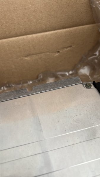

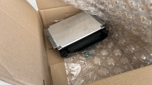

They sent it back in a box with “no protection whatsoever” , rattling around this super rare fragile part!!
The inside of the box was badly marked , actually denting the sides of the cardboard box where the ecu was hitting the sides , fortunately the ecu wasn’t damaged , such a let down!!
Pics showing how I sent it too them and well the pics tell a story!!
