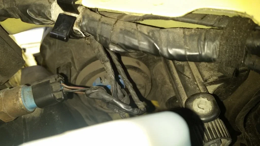

Got home now had a look my switch on the upper drivers side of radiator.
The wiring comes from the loom at the headlight

Easily done on an AC car.
The AC compressor and fan is probably not kicking in because the gas is too low but before you do anything make sure the AC fan actually works as it should- lots of detail on here: https://zroadster.org/threads/viscous-fan-issue.12814/page-2
Early 2.8's, mine included were wired incorrectly from the factory so the fan only kicked in on high which is too late really. I rewired mine so it kicks in correctly and no issues (also fitted a new aux fan as it was noisy and corroded).
