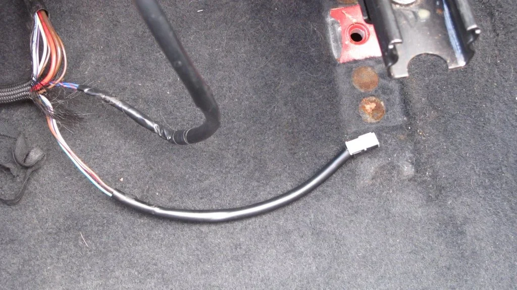

Whilst investigating the dreaded airbag light I found this connector. Any ideas? Thanks
rmoconnor41 Zorg Addict Joined May 25, 2021 Points 59 May 6, 2023 #1 Whilst investigating the dreaded airbag light I found this connector. Any ideas? Thanks
jonco Zorg Guru (IV) Supporter British Zeds The M44 Massive Joined Dec 6, 2011 Points 159 Location Chester Model of Z '98 1.9 Auto May 6, 2023 #2 Presume passenger side with no air bag fitted. Unused Occupancy sensor I believe. Attachments 1628B5F0-99BA-4557-B7B0-A6264883D8B6.jpeg 161.3 KB Views: 10
