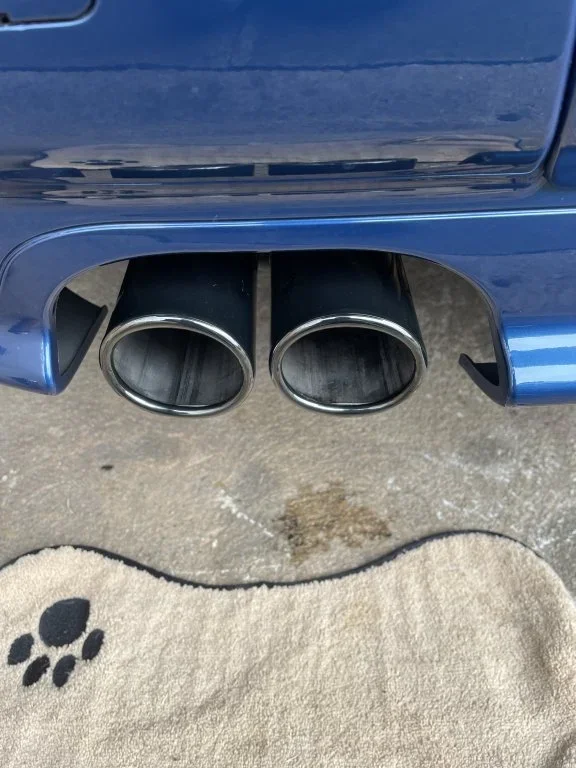

I never saw an an option for exhaust trims when I spec’d my 2.0 in 1999, it came with the black chrome trims which I changed for chrome ones. Have gone back to the black ones as I’ve de chromed the outside somewhat.
After a recent clean👍
