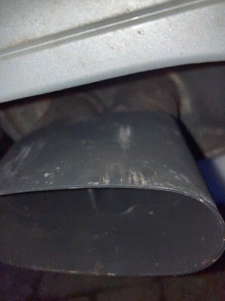

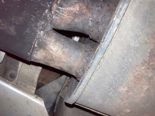

Is the exhaust tip on the exhaust welded on? I took off the outer shell. Pics attached and it looks like it is welded as one.
So what size oval stainless steel tip do i need? Anyone with any recommendations?

As far as I have been able to determine, the OEM tips (black or chrome) are out of production. You may have to just paint it

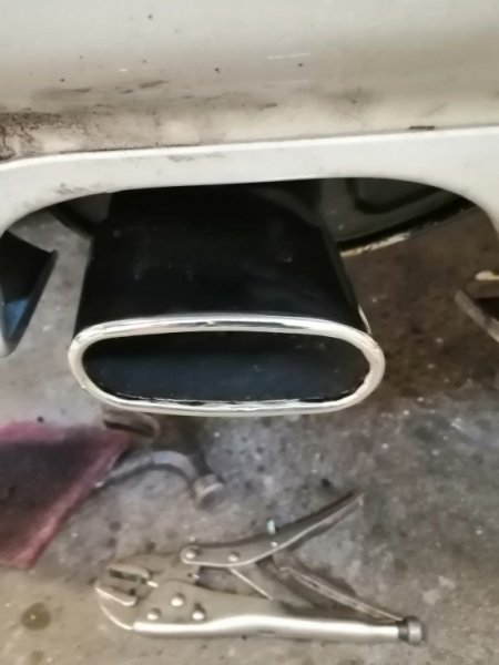

I have been digging around and found a chrome one from a Singapore website (name escapes me). So hopefully it will be of decent quality.

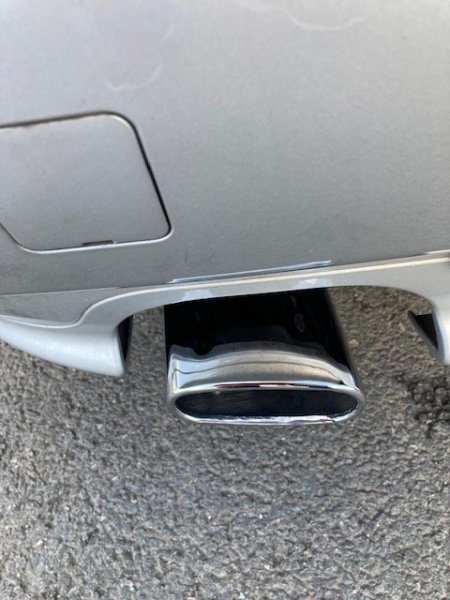

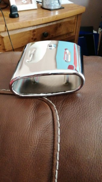

It arrived today - got it from here! I paid by paypal. I did not get a confirmation of order or despatch so I raised a complaint on ebay resolution centre after 9 days but it arrived ok so cancelled complaint.
Looks very good - excellent fit. Certainly improves the look. Came with a sizeable microfibre cloth for free!

Did this just bolt on after u had taken off the outer shell as u have shown in the initial photos?

Yes it was really simple - remove the outer shell of old one after undoing bolt - slide on new one, do up bolt which locks it against the inner. job done! :)
