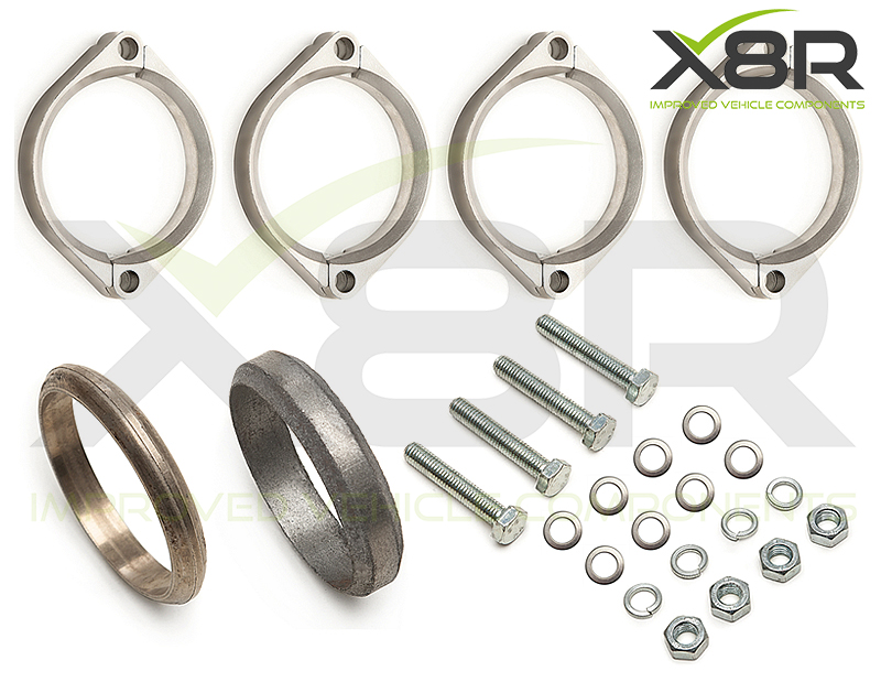

If you're not following the question boils down to this. Are the flanges welded onto the pipes or just stuck fast with rust? In other words I'd like to know if I can use one of these repair kits.
I know I have the option of having easily available weld-on flanges put on but that's more money, more delays and to be honest no guarantees the whole thing is going to line up unless I take it to an exhaust centre who will no doubt just want to put an entire new system on...
I could also cut both flanges off and put a flexible repair section on but these are typically 6" long and I don't think there's enough straight run either side to do this.
