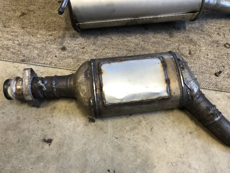

Cat replacement on-going; worse case scenario is OEM BMW for £1400 +, current scenario is a mate's scrapyard where there is a shedfull of removed Cats, and one can possibly be welded in. Given the state of the removed one this has been done before. I'm assuming that huge welded patch on the top is not original, nor the lamentable welds on either pipe?

Just back from the mate's breaker's yard. It does appear this one has been 'worked on' before now; to what extent we don't know. As it passed emissions recently he may split it again and fix the horrendous internal rattle, so see if that works, but he also talked about removing part of the insides (done it many times before, he says) which will fix the issue and still pass emissions next MOT. I don't think I've anything to lose in that even if this one fails next August, I'll still need to replace it with something and in the current state I'll not get any of the BMW deposit back that they require on exchange, so if I can find good S/H, great, if not then I'm no worse off than at present.

The plate on the top will for removing the broken up catalyst from inside to stop it rattling/blocking the exhaust. The reason it's on the top is so a bentctester can deny any knowledge of cat being removed. Some thing on boy racer whistling turbo diesels.
