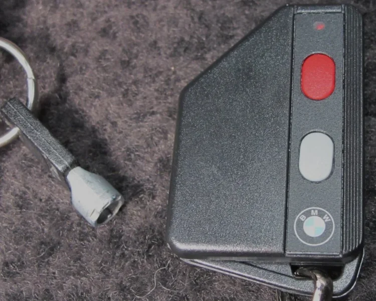

A picture of your type of key or remote might help?
The key is for turning off the alarm sounder under the bonnet.
