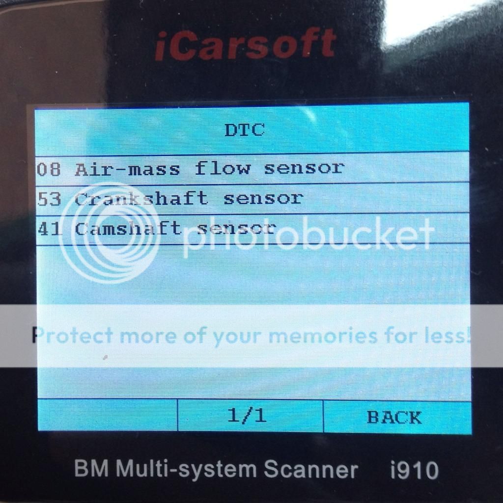

Hi all,
Have hooked my car up and read the codes and have gotten the following:
08 Air mass flow sensor
53 crankshaft sensor
41 camshaft sensor
The symptoms when driving all pointed to on or all of the above. I bought a code reader so I could see which of the 3 need changing. Didn't expect to have all three fail!
My question now is can it be that all three of these sensors need changing together or has failure one triggered errors on the others.
As these bits are fairly pricey (I believe I must use OEM only) I would like to hope that not all need doing at once.
I will be fitting the parts myself.

I'm sure a `real' expert will be along soon but the problem I had when I first read my codes is that you don't know whether they are current or historical.
I reset the few I had on mine and then went for a drive and re-checked them - fortunately only one came back in which made it a lot easier!.

^^^ Good advise, reset them, go for a run and see what re-appears.
Will your code reader allow you to see the date of the codes?
Can you see how many errors occurred for each fault?

Good tips.
Now I remember I've tried driving with MAF unplugged to eliminate that so that would have triggered a code for that for sure.
Not sure what extra features this reader has will check it out. My car is not OBD2 so not sure if it stores dates etc anyway.

So cleared codes and had a drive.
Just showing error 53 Crankshaft sensor.

Definately clear the codes, drive and check again, mine had 14 MAF codes as I'd been unplugging to see if it ran an differently while trying to trace a fault. Mine was crank sensor in the end, found after clearing a reading it again.
Don't buy cheap sensors go for BMW, wasted money on pattern one that ran worse than the broken BMW one!
Seems like I have the same then.y code reader just shows a fault not the number if times it's happened. I wondering that's because my car is not OBD2 or if my reader is not that fancy.

The symptoms I have are loss of power, lumpy idle (or cutting out) and hard starting particularly after the second time it's been started that day accompanied by some terrible sounds when cranking.
Ditto. Exhaust camshaft position sensor.I honestly cannot believe the difference in my car. If you had not driven it you would not believe the change in this car with a new sensor fitted.

Just to update:
I tried getting the crankshaft sensor out myself but despite having reasonable access to it (by removing the screen wash bottle, hose in front of sensor and moving the coolant bootle that is attached to the radiator out of the way) I could not get the hex bolt off.
So before I damaged it I put it back together and dropped it off at my garage who did the job along with mot and service.
The new sensor has solved the issue. I forgot how nicely this car pull, nicely surprised!
