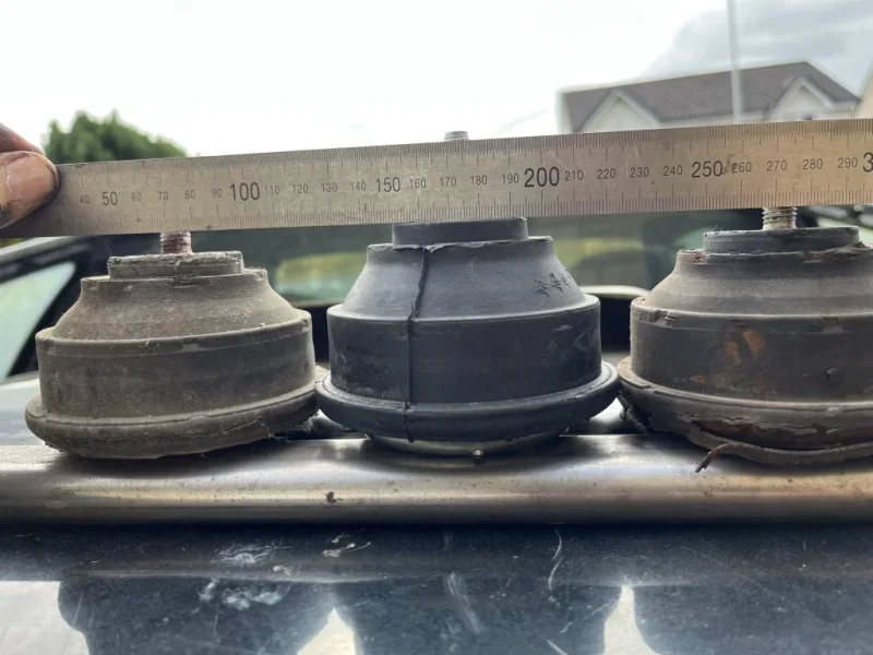

Yes, you’ll hate them.
Fitted a set of poly mounts to my sons e36 and he removed them fairly quickly, the vibration was horrible.
I’ve just fitted new mounts to mine, even though I’m going to do some competition in it I’ve fitted standard mounts.
The originals will be like this, squished.
