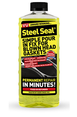

For head gasket concerns, look for constant bubbles in the expansion tank with the engine running (indicating combustion gases), white exhaust smoke, or coolant loss without visible leaks— if present, do a compression test or chemical block test.
If this is the issue use “steelseal” that works for closing small cracks and gasket faults.
